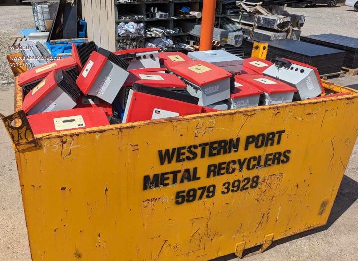

I found an image of the mother lode but I dont know where it is sniff...
I just found the company, www.westernportmetalrecyclers.com.au  (who would have guessed lol) maybe its worth a call next week ?

That picture makes me cry - A solar installer told me of the hundreds they literately threw in the tip over the past few years from school upgrades, these older SMA are getting as rare as hens teeth, and some people are still asking hundreds of dollars for one - crazy.

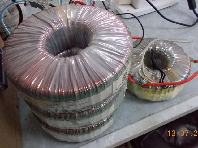

I was correct about cutting the Mylar tape first, I also use a chisel to cut/break off the green plastic base plate, this allows two pieces of timber to sit closer to the plug and fully under the windings on the under side of the toriod.
Only 1 medium strength hit with a "very small" sledge hammer and it popped straight out, the Mylar warp compressed between the windings and glued to the center plug is the only thing holding it in.
So easy, and to think that I bashed the living sh*t out of the first three to get them out

  KeepIS said  I was correct about cutting the Mylar tape first, I also use a chisel to cut/break off the green plastic base plate them out
No need to remove the green plastic, two pieces of timber against the plastic, not fully under the Toriod, one hit and it just popped out after scoring the Mylar tape.
Tried one without first cutting the tape and 4 big hits later, not moving, cut tape, one hit and it popped out. All 3 are done.
A 1.2kw toroid next to the 3 for comparison, plugs are gone.
