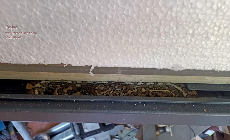

Last night I heard something get knocked over on the floor outside, had a quick look around no Idea what it was, next morning discovered the fan cover and mesh had been pushed off the top of the inverter cabinet and was on the floor, I had an idea what it was as there was a few carpet snakes around 2 nights back.
Thought I would open the door on the inverter cabinet and discovered a carpet snake at the bottom of the door against the batteries, it was a bit of a job getting it out as it didn't want leave, got it out eventually it was in good condition so put it outside, it moved close to the camera lens so its a little blurry photo, will have to seal up the cabinet a bit better I think.

Lucky it was only a carpet snake mate the only snakes I have on this farm are eastern browns and black snakes. The huge black snake that lives out the back of the farm I did see last year make a hurried exit off my road as I was driving up and with the head gone from view the snakes body was more than the road width so yes it is a big one.
My big problem is redbacks and lost count how many times i have been bitten.
