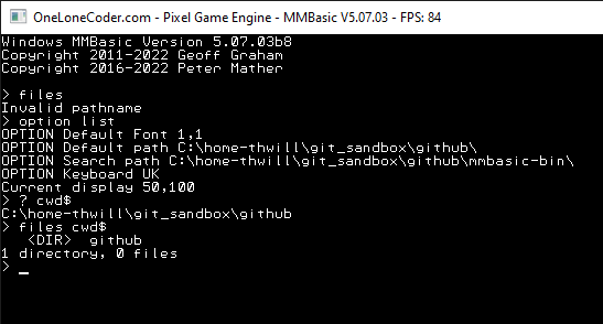

Hi Peter,
The last two versions posted seem to be have a significant regression, both displaying this behaviour:
Observe the misbehaviour of the initial FILES command.
Edited 2022-04-06 05:40 by thwill
Posted: 09:42pm
05 Apr 2022
Oops - got true and false the wrong way round
MMBasic.zip

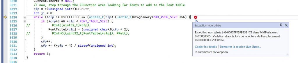

darthvader
Hello Peter
I just try to compile your latest code and get this error.
Is it something to set in the parameters to made it work ?
Here i am in debug mode , but when i go for 'Release x64' it compile but mmbasic start and after 2sec or so , the window disappear
Cheers.
Posted: 09:42am
06 Apr 2022
You should be compiling in release x86. It won't work in debug or 64-bit

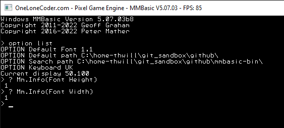

Hi Peter,
What am I failing to understand?
Posted: 11:09am
06 Apr 2022
  thwill said  What am I failing to understand?
That there is no space in FontHeight and FontWidth and no error handling to catch it if you use one .
Posted: 11:54am
06 Apr 2022
  Quote  and no error handling to catch it if you use one
There are hundreds (thousands ?) of places in MMbasic where additional characters in commands/functions are not trapped. To do so would increase code size and slow performance. The code with the space is returning the current font. I'm not going to change this
