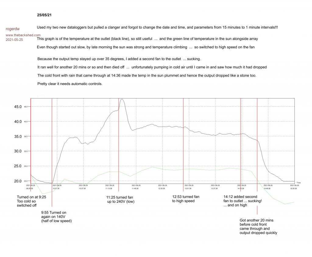

Well today was interesting again.
With Tony and Mike's input I decided to run the fans harder once the temperature rose  ...  to see how much affect the higher airflow had on temperature.
It held up reasonably well when I added another fan to the outlet  ...  sucking, to aid the other fan blowing at the inlet.
Unfortunately a cold front came through and temps plummeted and undid a lot of the good I'd built up. Desperately need some automatic controls soon.

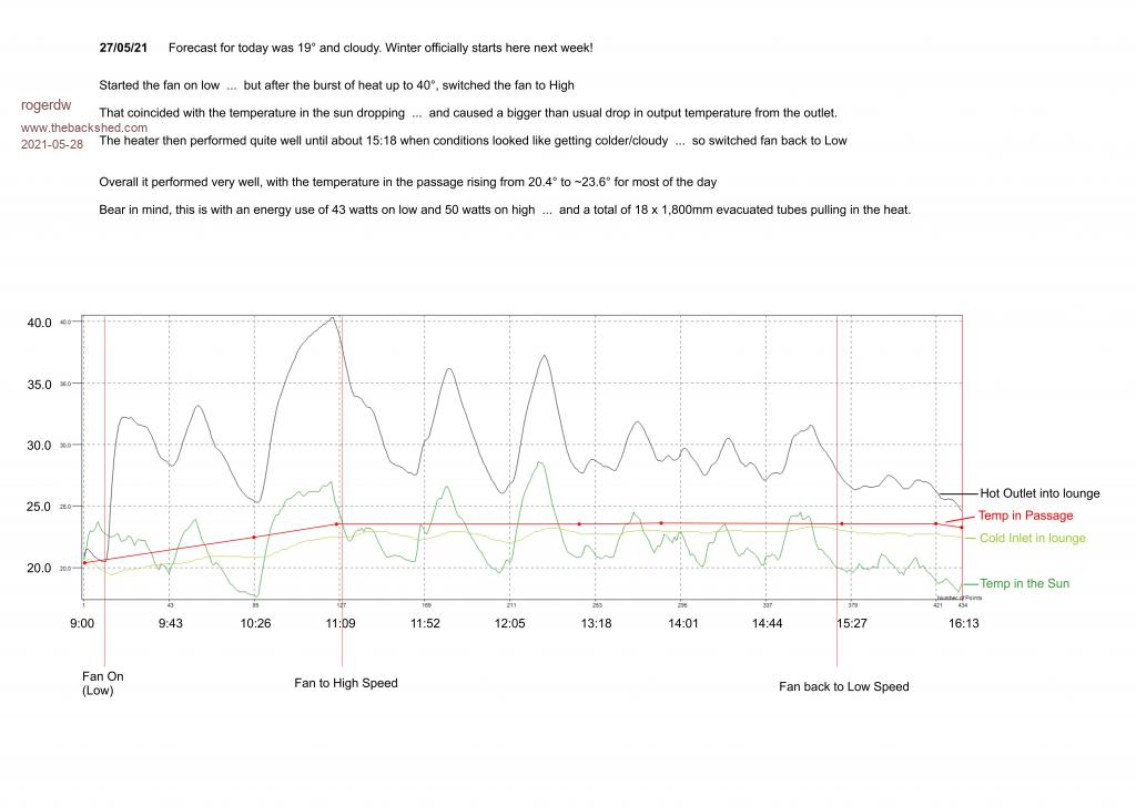

rogerdw
I haven't posted in here for a few days, but the system is still working well and I am very happy with the results.
I have been paying a bit more attention to the higher temperature levels when they occur  ...  and turn up the speed of the fan to push that heat through quicker.
Of course that reduces the output temperature  ...  but seems to increase the inside temperature more quickly.
I must get out somehow tomorrow and find a dc blower motor or two to carry on experimenting with.

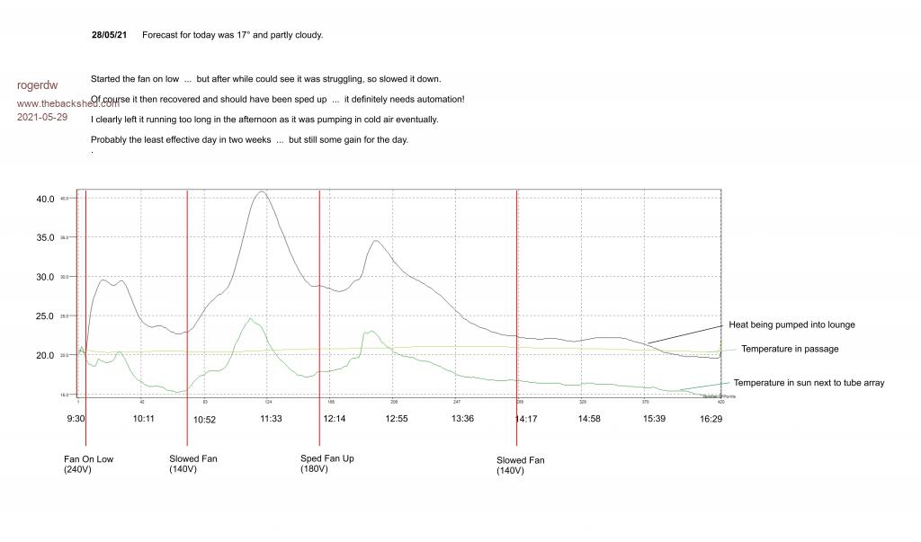

Posted: 03:30pm
28 May 2021
rogerdw
Todays results were probably the poorest of the last two weeks  ...  but considering the run I have had so far, am still very happy.
There was pretty much full cloud cover all day  ...  and in fact at one stage they were really black. Was expecting some solid rain, though nothing came of it.
It is amazing to me just how much the conditions must change during each day, despite the physical outlook appearing to remain much the same.
Uploading the data from the loggers is always a surprise as there are often temperatures that I wasn't expecting because I didn't see any sun or extra brightness  ...  but the numbers don't lie.
And it reinforces the fact that I need better control so that when excess heat is available I pump it out faster  ...  and conversely, when there is no heat, the fan needs to stop so I don't pump in cold air and undo all the good work the sun has already done.

rogerdw
Been a bit slack this morning, only got up around 9.30.
10.0 degrees outside but the sun is shining.
Placed out all the dataloggers and turned on the fan  ...  44 degree heat blowing into the lounge!!! Turned it up to high speed and has now settled down to ~30 after 40 mins. Edit: 1 hr now!
Because the array is at ground level the bottom 18 inches are still shaded by the fence, so should improve once it's all on the roof.
