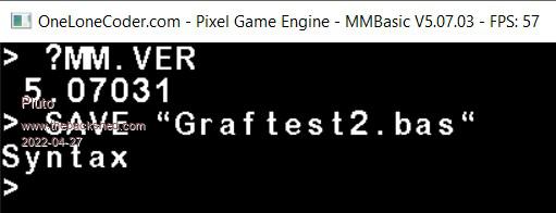

Posted: 07:22am
27 Apr 2022
Pluto
V5.07.03b10:
Running a testing program "Graftest.bas". OK
Trying to save a copy of the program as "Graftest2.bas". NOK
Program stored in the default MMBasic directory.
I am probably doing some stupid mistake. Need advice.
/Fred
Posted: 07:32am
27 Apr 2022
SAVE is not implemented as it has no logical use. Files are saved when exiting the editor or when using autosave. For your use you can use the copy command or the "save as" in the editor (ctrl-W)
NB - doesn't exist on CMM2 either as both implementations are "disk-based"

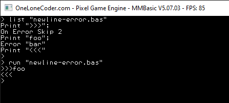

Posted: 09:49am
03 Jun 2022
And here is another one for you:
Observe the spurious newline that has been inserted as a result of throwing and skipping an ERROR.
Edited 2022-06-03 19:56 by thwill
Posted: 10:42am
03 Jun 2022
Will fix first , the second is too obscure to waste time on - sorry
