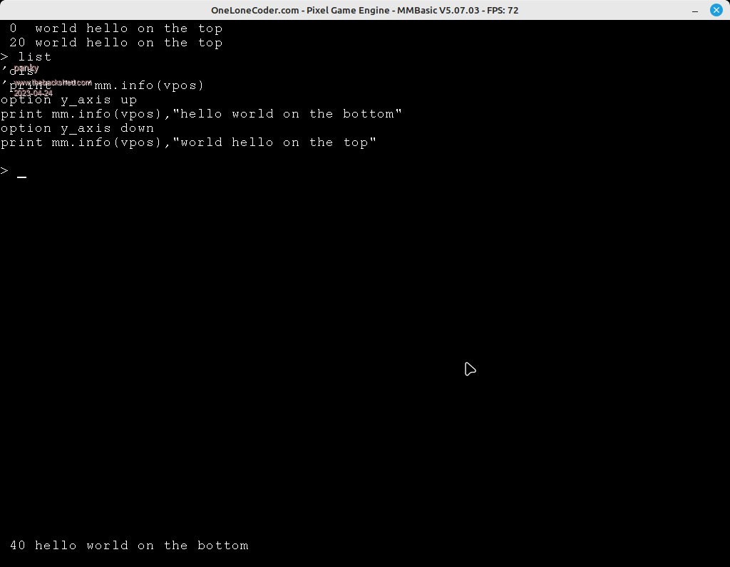

Is this a bug in MMBW 5.07.03b15?
When OPTION Y_AXIS UP is in effect, PRINT does nothing.
option y_axis up
print"Won't see this"
option y_axis down
print"This is OK"

OK, I found b16 but I still get no printing while OPTION Y_AXIS UP is in effect. I used the same options as in your list to test it.
Edited 2023-04-24 13:05 by toml_12953

panky
@toml_12953
Not sure what is going on mate - works for me on both Win 11 laptop and Linux Mint 20.1 under wine to a large screen monitor.
Anyone else seeing this? Any ideas for Tom?

toml_12953
  panky said  @toml_12953
I only see the second line. I should see both.
You see this? This is what it should look like:
Won't see this
This is OK

panky
Tom,
I think I see what the problem may be.
If you add CLS as the first line of your program above, the bottom line does not print. If you then add a PRINT command on line 2, right after the CLS it prints as it should.
It appears that CLS does something wierd?
At the prompt enter CLS:RUN - the problem is there,
enter just RUN, everything works (on both my Windows and Linux machines).
This might be one for Peter unless I am missing something obvious (ALWAYS possible ).
D.

disco4now
{QUOTE]
It works OK for me. Note that the "You wont see this" is at the bottom of the screen.
Try MODE 1 for an 800*600 screen to ensure that its not just that your last line is not visible. Check your have not scaled the font above 100% in windows settings if the bottom line is not visible.
