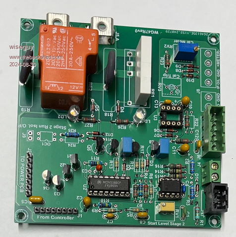

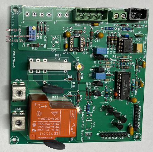

wiseguy
Here is a picture of the second stage control board from 2 aspects.  Note I have not installed the connectors or op-amp for the peak reading circuit as I really just wanted to test the control functions.
Note the Main relay does not switch 30A it closes and opens with minimal current flow, the second stage drive is enabled and disabled to avoid high current relay switching. The smaller relay in series with the NTC anti surge resistors only passes a single cycle of current ~ 8A max with 2 x 15R NTCs and then only if it is switched at the worst possible time, thereby driving the second toroid into saturation.  The current quickly reduces over the next few hundred milliseconds to normal magnetizing current.  Note the smaller relay can be upgraded to a 10A or 16A type with the standard DIL footprint instead of the SIP type I used, the board accepts either type.
Q1-Q4 are backwards for the silkscreen as I used different FETs to the BS170s that have a different pinout - the outside pins are reversed.

Cpoc
Wow that is a lot more complex than I thought it was going to be.
Amazing job wiseguy truly a work of art and with no nano code needed just pure electronics.
This is going to be one hell of an inverter that not only can you swap out parts if needed but that you can also replace individual components.
For us old guys with grey hair that our eyes don’t work so well this is a God send due to not having any SMD parts that are so small that I cannot even see them.
However I still need my old man glasses when I will assemble these boards.

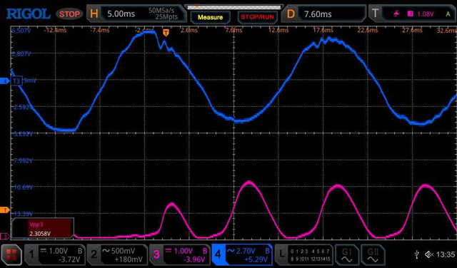

Just a quick update, I spent the day with the DSO, comparing the DC input current waveforms.
I can confirm that at 510A combined DC input, both Inverter stages show EXACTLY the same current sharing at 255A each, right from when the load first starts and throughout the entire 3 second startup waveform, they are exact mirror images, current load sharing is 100% from Idle to whatever you can throw at.
The total current draw is 40 to 60 amps less then starting this load with the single Inverter version.
I still haven't captured the AC voltage under this load, but I bet it's holding higher, I was so busy with the two Current sensors. BTW the peak current meters on the front panel both registered just under 260A each as well, I went through and really got those meters calibrated together.

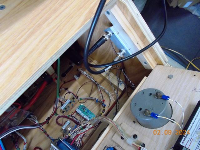

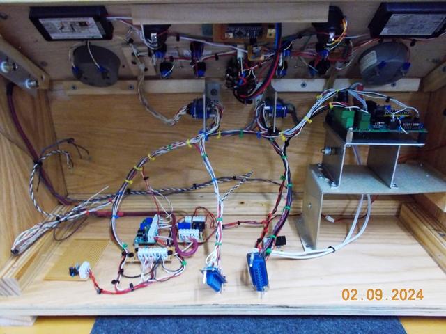

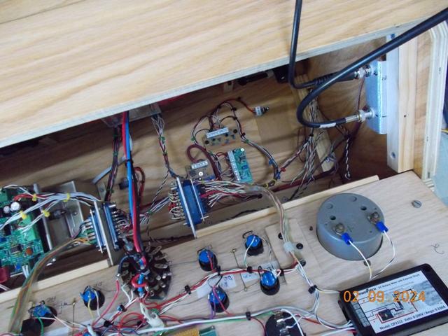

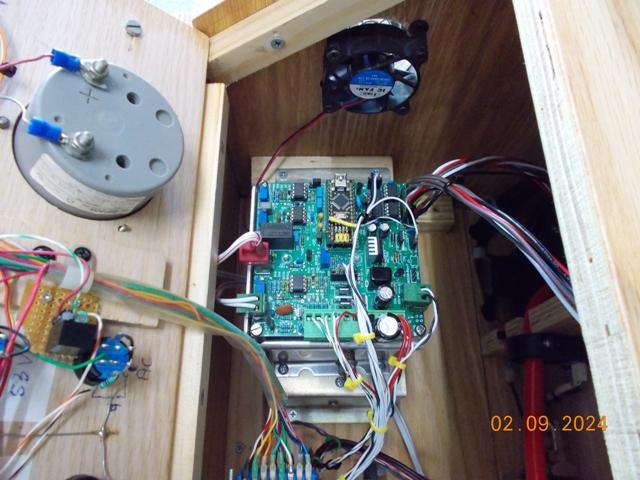

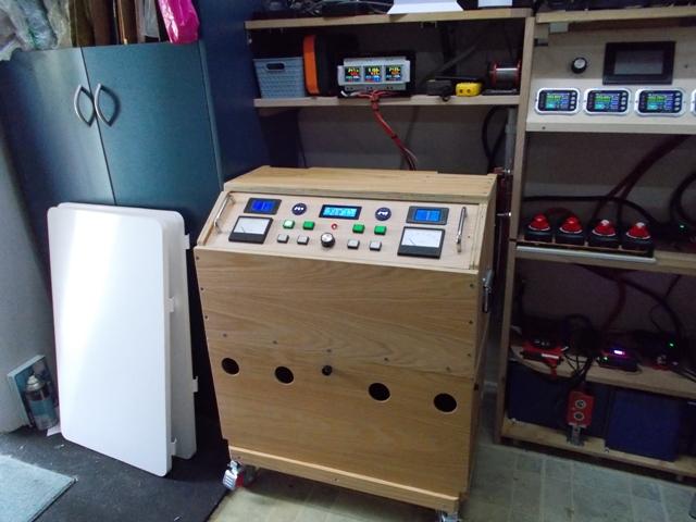

I had to rewire the cabling to the Hall sensors - I had a lot of switching noise on one sensor.
I had gone to great lengths to keep 53V and AC sensor signals out of the cabling, even running a separate 5A 3-pin plug in cable from 53vdc input bus, precharge resistors and Kilovac coil enable line directly to the power switch.
Anyway, I made the change last night and tested this morning - YES fixed.
I have two BNC connectors for two 500A Hall effect current clamps for easy monitoring of DC input currents for each power stage with a Digital Storage Scope, those sensors are accurate to over 750A each.
The BNC connectors are hidden behind the front panel, I thought this was this best solution as the font panel simply lifts forward to gain access, and the front panel can sit back against them when testing or capturing startup data.
The messy cables and Veroboard on the bottom right of the cabinet are for the last of the sensor indicators and AC current trips.
Nano control board, a tiny fan to keep air circulating through the control cabinet.
20 seconds after the pictures above were taken, here is the upper cabinet on the bench ready for adding the last AC current sensors indicators.

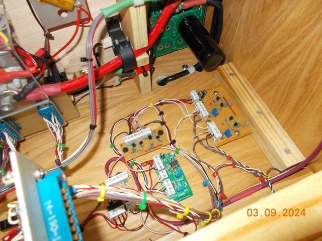

I finished the two AC latching current trip indicators and the Over Current drive signals to the Nano controller master current trip indicator and reset switch.
All the OC trip Boards are shown in the following photo, the above dual AC board  (large Veroboard) combines with a board for two Peak DC input OC indicators and Master OC drive, and two boards for fast attach slow decay drive signals to the control-panel meters, each displays peak DC current into the two power boards.
The only thing to do now is to build and test the optional 1-stage/2-Stage control board on the Inverter.
I've decided that with my usage and random high transient startup loads, I won't be including this board in my build, leaving the Inverter hard wired as a constant high power Dual-Power-board and Dual-Toroid Inverter.

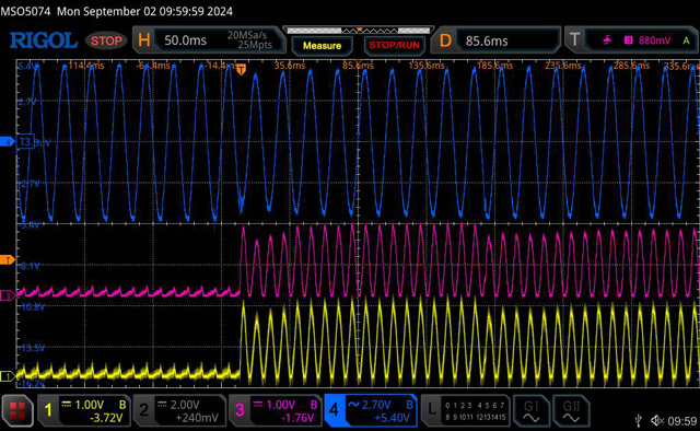

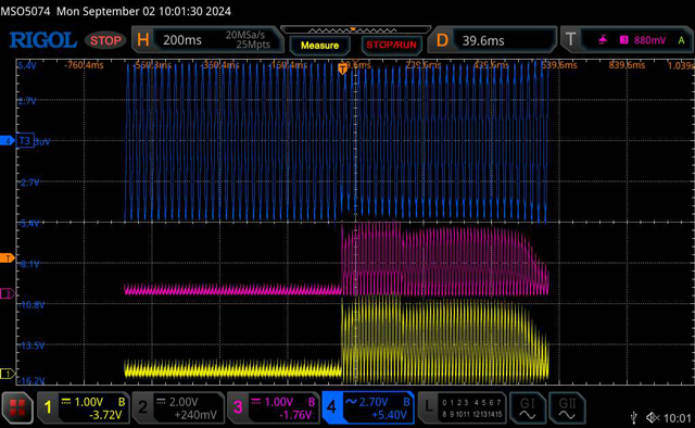

Posted: 10:13pm
02 Sep 2024
KeepIS
The inverter starting the BandSaw.
Blue: AC on the Mains some distance from the inverter
Magenta: Power stage 2 current
Yellow:  Power stage 1 current
Start up current 235A on each power stage, total peak input 100Hz waveforms of 470A.
The lower waveform currents are identical, just a bit more noise on the lower.
Zoomed in on the initial startup. The slight humps on the left of the screen are the normal Inverter load running currents of around 600 watts each (1.2kW) prior to powering the BandSaw.
BTW This 2 meter high BandSaw is not a big load when compared to other workshop equipment.
