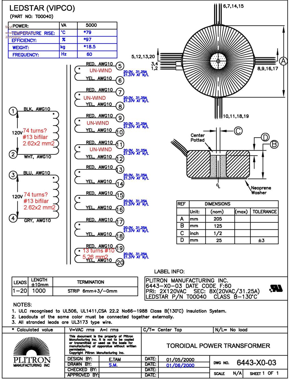

For reference here is the data sheet of the original toroid transformer with my notes in red.
Calculated weight says 18.5 kg (40.78 lbs). Seem that my mod added only 1.3 lbs.

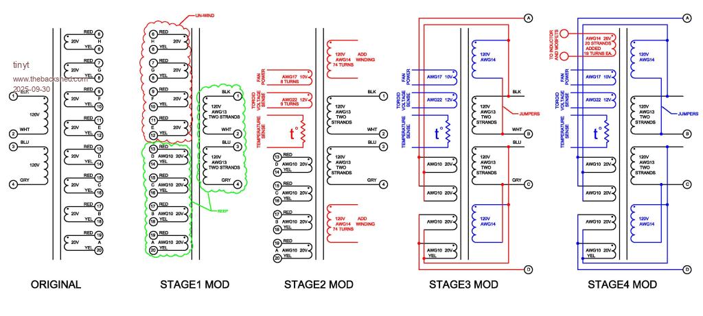

Here also shows my modification in stages.
Using my notes and the picture above, and using number of turns instead of voltage, turns ratio is ((74 + 13) x 2) / 19 = 9.15
Secondary cross section for the 74 turns (120V) is (2.624 x 2)  = 6.8757 mm2
for the 13 turns (20v) is (1.6277 x 2) = 5.176 mm2
Primary cross section for the 19 turns (26v) is 1.6277 x 20 = 32.55 mm2
I hope I got my rithmetic right.

Posted: 05:11pm
30 Sep 2025
analog8484
AFAIK, the only inverter of similar power rating that can start a 5 ton A/C (without soft start) is the Schneider XW PRO which is rated for 6.8kW and has an 80 lb transformer.  It's remarkable that your inverter can start a 5 ton A/C with a transformer that's half the weight.
That turns ratio is certainly closer to typical.  So, is the actual voltage ratio similar (26VAC to ~238VAC)?  If so, it seems the original transformer datasheet voltage ratio was a bit off?
Hmm ... the build thread and the diagram above indicate 14 AWG for each strand for the primary winding which  has a 2.08 mm2 cross section.  The 1.6277 number looks more like the diameter of 14 AWG.
For the secondary winding (the 120V portion), the build thread and diagram indicate 2x13AWG + 1x14AWG.  The "2.624x2" above would mean only 2x13AWG?
Can you verify?
In any case, if you ever run the 5 ton A/C again with the inverter, it would be great to know how low the voltage gets.
Posted: 11:40pm
30 Sep 2025
tinyt
  analog8484 said
Can you verify?
Yes, you are correct, at my age I keep making mistakes now. AWG 14 cross-section is 2.08 mm2.
And you are also correct for the secondary:
The 120v section is 2x2.624 + 2.08 =  7.328 mm2
And the 20v section is 2x5.267 = 10.534 mm2
The primary is 20x2.08 = 41.6 mm2

Secondary(L1-L2) = 237vac
Primary = 26.37vac
Primary including the choke = 32.5 spwm
Calculated turns ratio: 237/26.37 = 8.987
