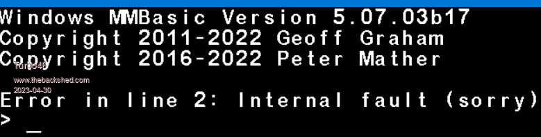

Posted: 09:56pm
29 Apr 2023
Turbo46
Thanks Peter, I tested it with this from your post:
a$="123456789"
? math(crc16 a$,9,&H1021)
and got this:
Bill
Posted: 10:05pm
29 Apr 2023
Here you go
MMBasic.zip

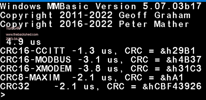

Posted: 10:40pm
29 Apr 2023
Turbo46
Thanks Peter, That worked.
I tried Volhout's test program and got the same values as a result.

Much faster though, the times are negative you must have added a flux capacitor to MMB4W.
Bill
