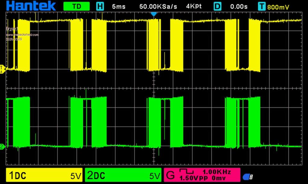

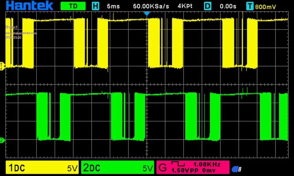

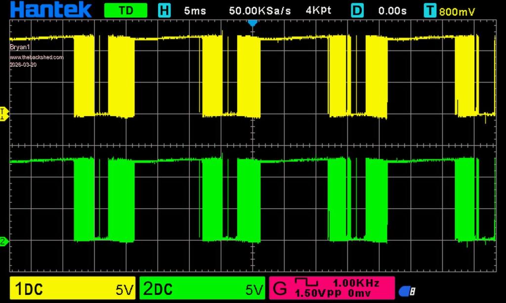

Posted: 01:24am
20 Mar 2026
Bryan1

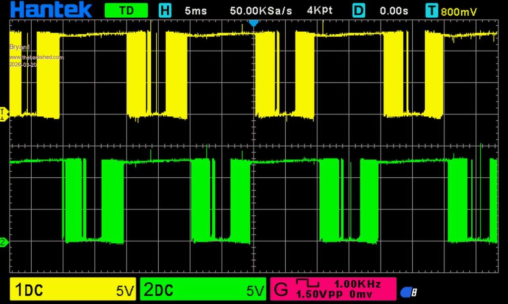

Well had a bit of break from this inverter project and got back to it this morning, replaced 2 of the TIP chip sets leaving me one spare set
Anyway got it all sorted I think
Ch1 L01
Ch2 L02
Ch1 L01
Ch2 H01
Ch1 1 L01
Ch2 H02
Ch1 L02
Ch2 H02
So after lunch time to put a NEW HY5608 mosfet on each leg for the next test.

tinyt

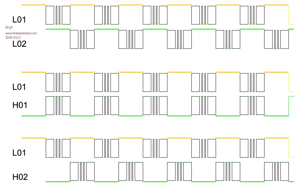

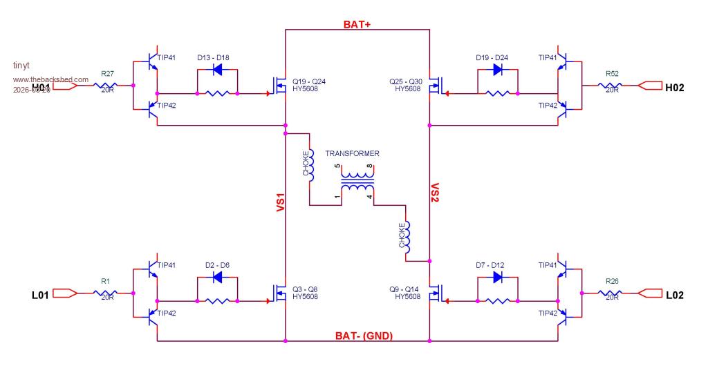

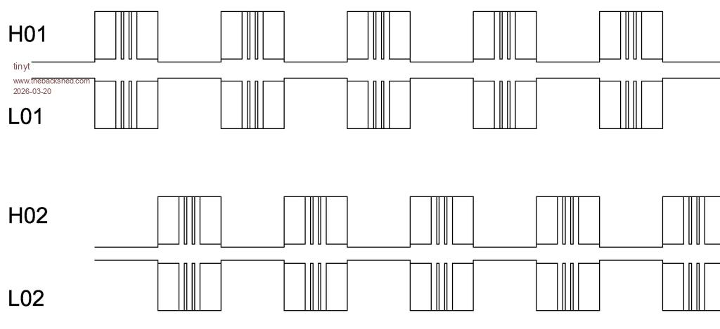

  Bryan1 said  Well put one mosfet on each leg and when I turned the control board on R52 the 20 ohm resistor started letting out that magic smoke   so replaced both 20 ohm resistors on the high side only to find it did it again.
Here is a simplified schematic of the inverter.
In your scope capture of L02, H02 both waveforms are the same.
So, Mosfets Q9 - Q14 and Q25 - Q30 conduct at the same time creating a short condition. Probably damaged the mosfets, the TIPs, and the IR2184s.
You have to make sure waveform time and voltage relationships for the signals are correct. Here is a sketch for reference, note the position of the wide lines with respect to their 0 volt.
Also, ideally, one should probe directly at the mosfet gates but a slip of the probe tip can cause damage, so it is safer to probe at the diode pins. If it shows good waveform, you know that the resistor and the TIP pair are working.
Edited 2026-03-21 00:54 by tinyt

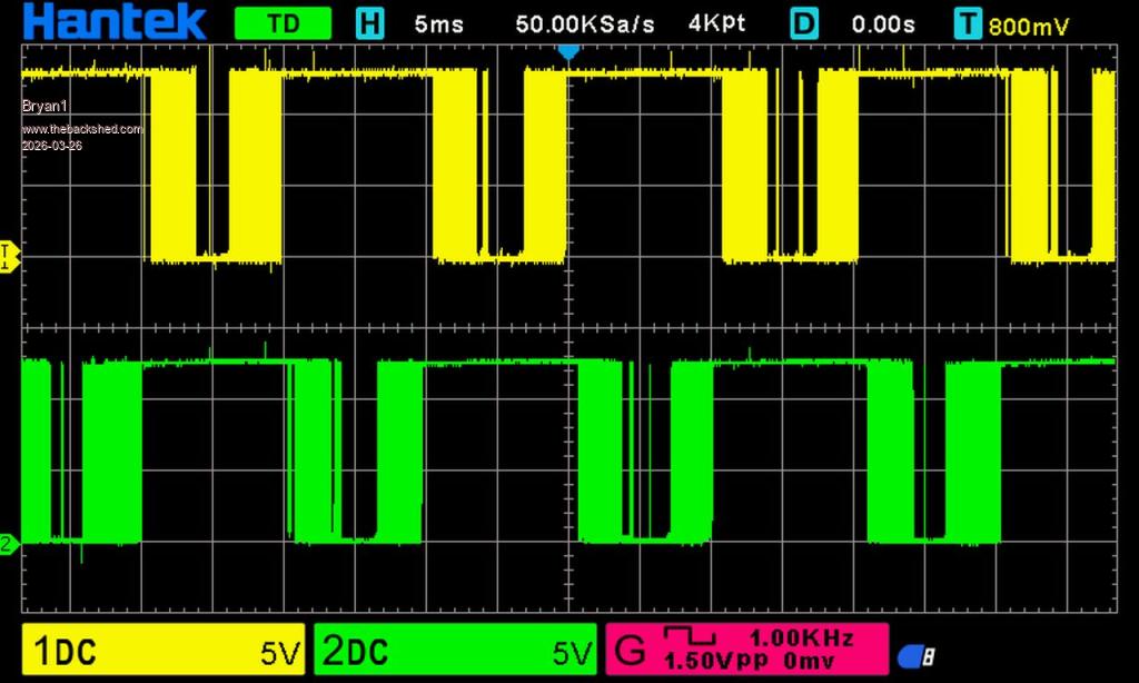

Posted: 03:00am
26 Mar 2026
Bryan1

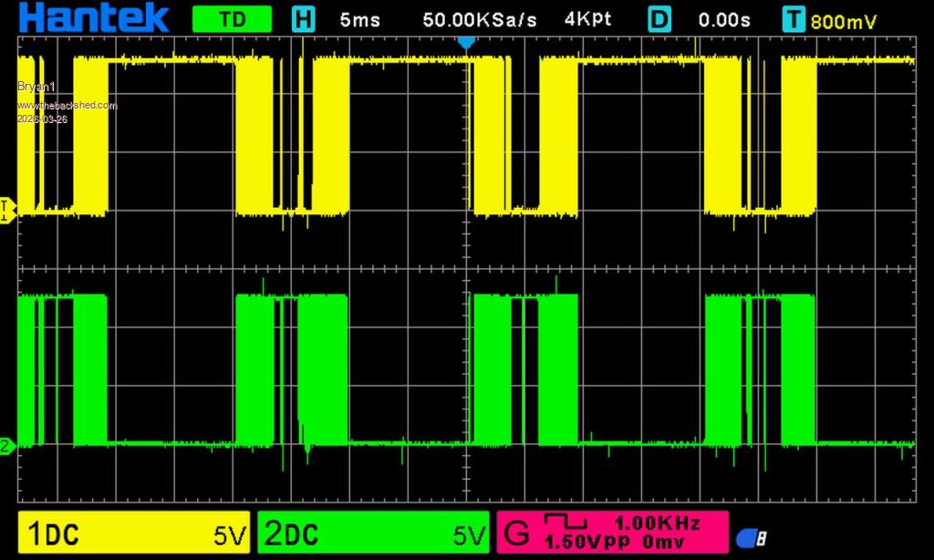

Well I took the mosfets off and set it up again to test
L01
L02
L01
H01
L01
H02
So from I can work out the top track on H02 which is on the top layer isn't making a connection, now I did solder in a jumper from the H02 pin to R52 the 20 ohm resistor.
When I tested with the mosfets in the R52 resistor would burn out, so I'm thinking of taking off the 10 pin connector and solder in some short equal wires to a new 10 pin connector so all the top tracks will have contact.
It is good to see the TIP chips are still proving good too
Edit: Now there is a short track on the bottom layer going to a via that I could scratch to expose the copper and solder in a jumper back to the pin on the 10 pin connector so H02 is connected.
Edited 2026-03-26 14:08 by Bryan1

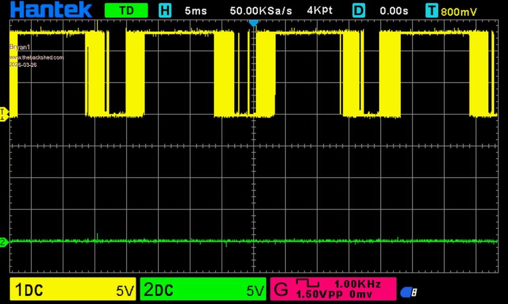

Posted: 04:39am
26 Mar 2026
Bryan1
Ok getting one step closer   I put a scope probe on pin 7 of U2 and the wave form was lucky to be a volt so swapped out the IR2184 and now got a full waveform coming from pin 7 but no action at all on H02 with the scope.
Also I have confirmed the H02 pin on the 10 pin connector is in contact with R52 which was replaced this morning so I will replace the 2 caps and then try again.
Ok replaced both caps and put them in high to ensure the top solder joint was done and still no change.
So I remembered I had that 10 pin breakout cable so plugged that into the control board
Now the picture doesn't do justice to the scope but it is clear the H02 signal is going to the 10 pin connector.
I do have one pair to TIP chips so I will replace them and then thats everything replaced on the H02 side.

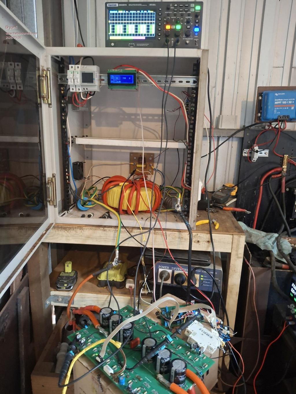

A little more progress, 10K resistors at the 4 TIP42C transistors, checked and everything still seems to work, next I connected a toroid with a 15v primary and a 10ohm 25w resister (all I had) between the VS1 and the one toroid primary no chokes in the primary yet but really should have spent the time to put one in.... then put a 4Uf cap on the secondary no filter and just a volt meter.
Tested and got a little over 53vac at the secondary using 1 amp at 13vdc from the PSU, the 10ohm resistor was getting hot, it didn't like the 4uf cap on the secondary, reason would be I had no chokes on the toroid primary, so removed the 4uf cap on the secondary and tested all the way up to 26vdc input and now have 236vac on the output and using .33amp.
Close to calling it working.
Next will be to make up the chokes and move the it outside to do a bit more testing, not liking it sitting on the bench for obvious reasons.
Can't see any faults yet so yours should have been as straight forward as this has been.....up to this point....I can still mess this up so not going to call it 100% working until after.

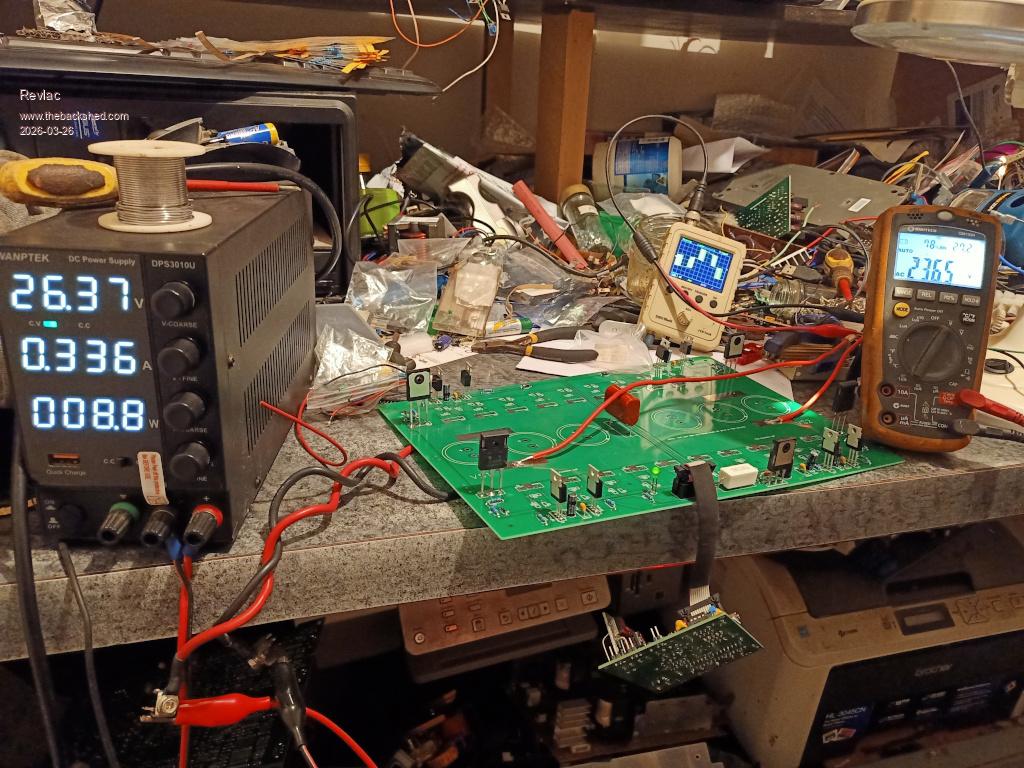

Posted: 08:16am
29 Mar 2026
Revlac

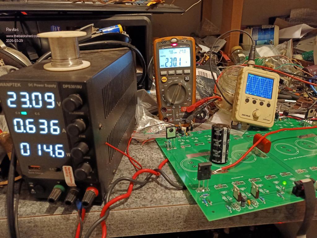

Thanks for the suggestion Peter , This is the first time I put a resister on the primary (of any build) and obviously not needed, I should have realised that earlier and removed it, I don't like blowing things up its so much extra work finding all the parts that are no good and replacing them, been there done that.
I replaced the filter cap with a 4.7uF just removed from a grid tie inverter carcass wired it in place and.............beautiful result.
No VFB connected yet, just the voltage from the Lab PSU.
Photo says it all.
Now we just need Bryans built to work.
