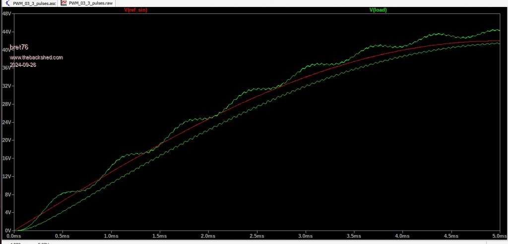

Sorry, I got stuck on the operation of the L+C.

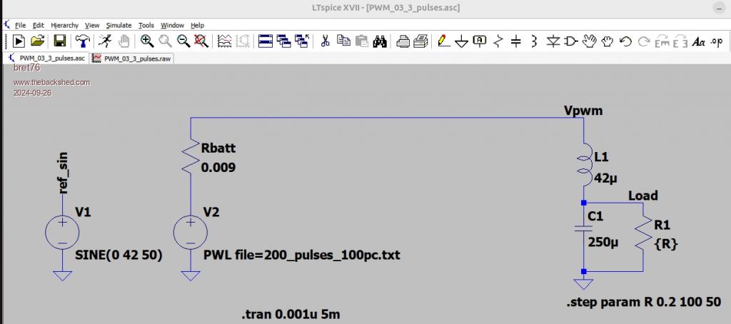

I tried to simulate with a LT spice 1/4 of a sinuzoid (1/4 of 50Hz):
- in red a perfect sinuzoid for comparison for the shape (the voltage values ​​are not correct because they depend on the battery, the transformer, the pwm...).
- in green / upper curve the voltage at low load (R=100). We can see that it ripples a little. It does it more or less depending on the L+C values.
@KeepIS: can you confirm that at low load, you find this ripple? I want to make sure that my calculations are not too wrong vs reality?
- in green / lower curve, the voltage under heavy load (R=0.2). We can see that it shifts from the sinuzoid, especially at the beginning. Maybe an idea to explore: tinker with the PWM signal to slightly increase the PWM signal duration on the 0/3µs range.
For those who would like to try, it's interresting, because the software can extract voltage, current, power, fft, harmonic distortion....
We can therefore have an idea of ​​the evolution of the no-load power or the distortion vs. the value of L+C+load.
If I'm off topic, feel free to tell me!

If you are looking for a simulation for the AC output from my inverter, then you have not included the dual stage AC filter that's in the Inverter.
Unfortunately I can't access the input to the AC filters, at least not without removing the filters and undoing a very large double terminal block.
Obviously you will see some spwm ripple at the AC output before the filter, but the level varies with so many variables in an actual running inverter.
Sharp transient Switching Harmonics are also mixed in along with Power stage DC ripple and resulting waveform distortions. All influenced by FET switching speeds, power stage Filtering layout and values, cabling interactions and coupling effects ETC.
When I get a chance, I can set up my "Inverter Test JIG" with that value of Choke and post a Capture for you if that will help you with what you are trying to achieve or verify.
I have seen the slight ripple in the lower trace which is quite common, but I doubt that anyone is going to look any further into SPWM generation for a "possible" minor or simulated imperfection in this powerful and proven design.

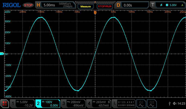

I just had a look at the AC output of the Inverter (running the House and workshop), using a TekTronix 100Mhz DSO.
With part of the sinewave zoomed in to almost a straight line across the display, as I zoomed in, there was nothing but the finest step appearance when fully zoomed in, which could be just the limited resolution of this Tek DSO at that zoom level.
This is a capture of the Dual Inverter output with a few kW of load using a 340Mhz RIGOL DSO

Indeed, I missed the EPCOS filter. When I read your story, I didn't understand its usefulness. To understand better, I removed everything that did not seem useless to me.
Now I understand their importance better!
So I'll have to put some in too.
Above all, don't modify your inverter, it's much easier for me to change the simulation if necessary (a few clicks and it's done)!
David

Your simulation confirms my dso images when probing a hf inverter (hv bridge and lc filter). In a lf inverter some magic hapens in the transformer. So you will need to take that in to account as well.

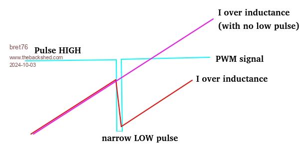

I just did a quick calculation (R mosfets + R cable), you are almost at "Pulsed Drain Current" ! Whaoo !! That is safety, but without the straps   . Good done !
Maybe some low and narrow pulses are missing in some conditions (1 pulse missing => 2xI , 2 pulse missing =>3xI), leading to I increase => µH decrease / saturate => more I ...
Red : normal current over inductance
Purpule : current if low pulse is missing
Luckily you explained it to me, I was going to do the opposite (put a big cable in the inductor to reduce the heating)

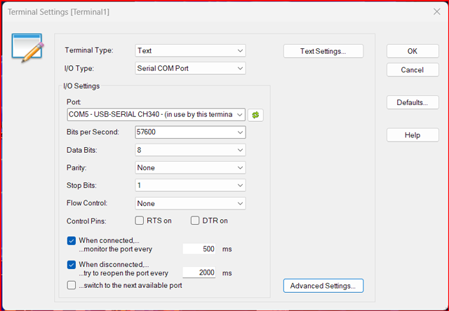

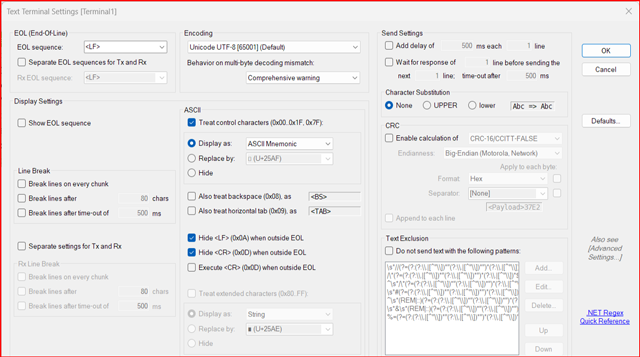

I had a question about setting up "Tera Term" Terminal program to work with Nano Menu system in my Code, and another about setting up YAT.
So the easy one is Tera Term, In Setup -> Terminal, set New Line for RX and TX = LF,
Terminal ID is VT100, Local echo can be on or off.

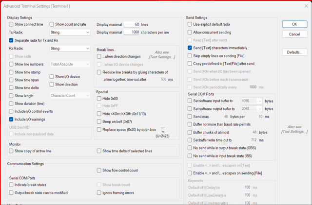

YAT:
Note: I spent all of two minuted on this Terminal program, I have not used it before, just checking it worked correctly, so I'm not really interested if something is incompatible with your YAT religious or other technical manta.
After this very brief look at YAT, I do like the program and will look at it in more detail when I get time.
Screen Grab for YAT:
Terminal.
Text Settings.
Advanced Settings.

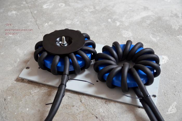

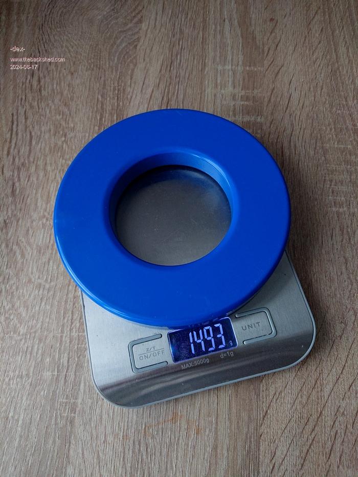

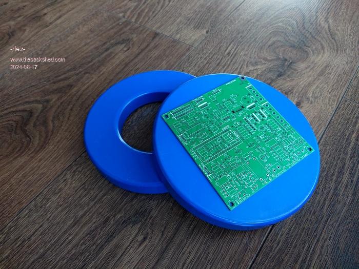

It seems to me that you would be one of the few people who could fully use the potential of these large cores. I checked how much it would cost to send them from Poland to Australia - twice as much as their value + customs duties and taxes.
  KeepIS said  I had toyed with trying that, but even the smallest toroid I have is to big to fit.
I would love to have tested the ones posted by dex, but I can't find any way to get them to AU for a reasonably price, and they would just fit in the housing.
  -dex- said  New power chokes
By winding 13 turns, I obtained 25uH for a single choke. The saturation current is at least 310A.
There is still some space there, but I didn't have enough wire - in practice, one turn was more than calculated.
The cable is the same as on the toroid transformer - 50mm2.
They are certainly more than adequate for current applications. But who knows, maybe one day I will dare to more extreme power tests
Here are the cores, controller board for size reference.
