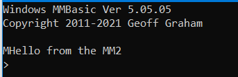

Turbo46
Sorry Peter, This what I see. I am running it from MMEdit but I don't see how that could affect anything.
Same program with MMBasic DOS
This program still crashes MMB4W.
OPEN "com3: 38400" AS #2
input #2, test$
print test$
CLOSE #2
Bill

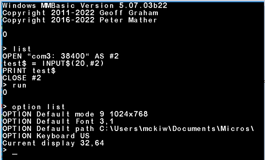

What is the zero when you start up? Have you got something running - try deleting .options
Posted: 11:43am
21 Dec 2023
Turbo46
The zero comes from running the program at startup, MMEdit runs the program when it starts MMB4W. It's the same zero that you see after I type RUN. I have no strange OPTIONS set I believe.
One thing though, the program being run is not in my default directory it is in a subdirectory of /micros > /micros/MMB4W but I can't see how that can have any bearing. But...
Sorry off to bed now.
Bill

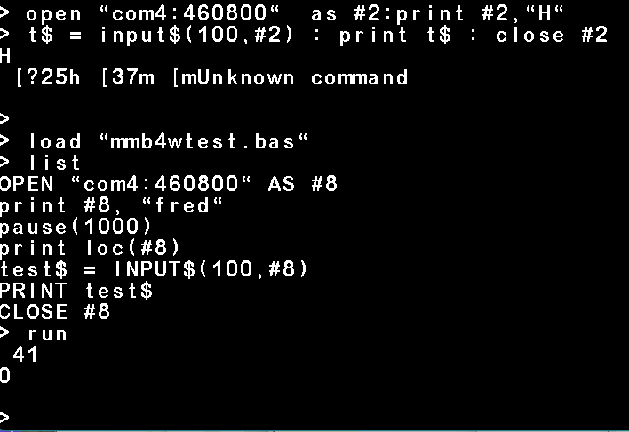

Posted: 08:04pm
21 Dec 2023
Sorry, but I still can't get it to work.
Works OK from the command line as per Phil but not in a program.
Running in a program does send to the cmm2 and the receive buffer gets the data returned but unable to retrieve from the rx buffer.
OPEN "com4:460800" AS #8
PRINT #8, "fred"
PAUSE(1000)
PRINT LOC(#8)
test$ = INPUT$(100,#8)
PRINT test$
CLOSE #8
Edit:
If you use
INPUT #8, test$
it works OK so the problem is with the INPUT$(nn,#x) command.
Edited 2023-12-22 06:40 by TassyJim

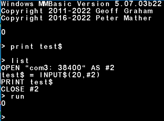

Turbo46
Hmmm. The plot thickens. Maybe the variable name TEST is part of some internal debugging code:
The first zero is because the program is run immediately it is loaded.
It does work on MMBasic DOS.
Bill

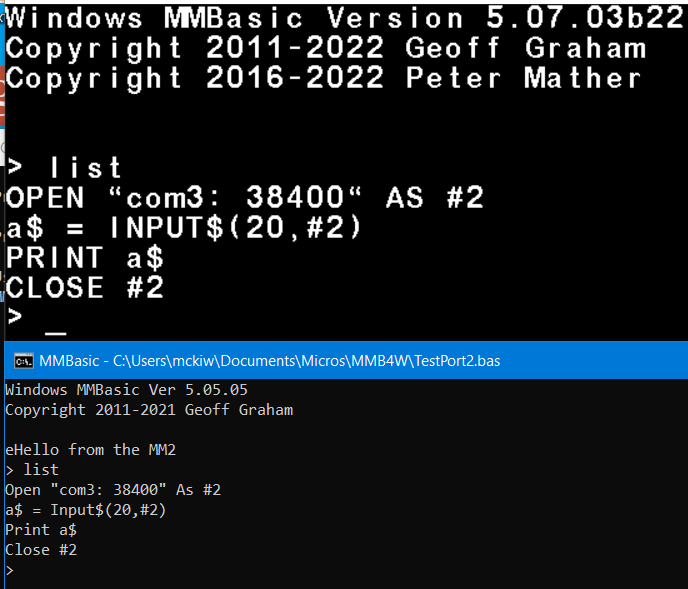

Turbo46
So I changed the name from test$ to a$ and ran it again.
As you can see it doesn't print zero now but prints nothing. Again it does work on MMBasic DOS.
I wonder if MMBasic DOS empties the com buffer as it opens the port while MMB4W doesn't?
From that and TassyJim's test it does seem the TEST is some kind of internal variable that overrides it's use in a program.
Bill
Posted: 03:26am
22 Dec 2023
"test" is used as a variable name in the source code in commands.ccp and one of the json files.
Perhaps it has escaped it's local status and become global.
