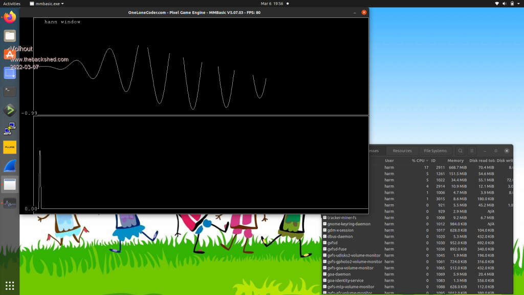

Posted: 06:57pm
06 Mar 2022
@Peter
The efficiency increased significant. But you tuned it a bit to far, If you run the fft program and press "w" a few times slowly (do not repeat too fast) the graphics driver stops before it is finished drawing.
The top graph is drawn partially.Also some text is not drawn.
When you repeat the "w" fast and regular, the drawing completes. I guess you have an algorytm to sleep the drawing engine that could be tuned.
P.S. this is MMBasic on Wine. Maybe this does not happen in W10/W11
Edited 2022-03-07 05:00 by Volhout
Posted: 09:23pm
06 Mar 2022
Likewise here on native Windows10
Switching to mode 10 seems to be the worst.
Posted: 10:16pm
06 Mar 2022
Does this fix it?
MMBasic.zip
Posted: 11:20pm
06 Mar 2022
Fixed it for me...
Posted: 07:41am
07 Mar 2022
Yes Peter,
That fixed it for the FFT demo program, tested on Wine(linux) and W10.

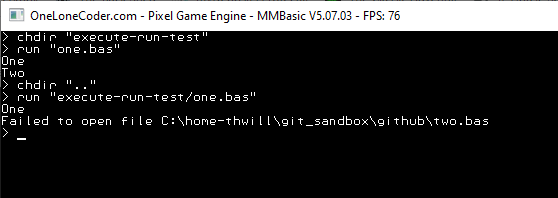

Posted: 10:28am
07 Mar 2022
Good morning Peter,
Thanks to your recent changes I've almost got my unit-test framework up and running and things are mostly green.
However here's a blocker for running the entire suite in a single command.
Setup:
1. MKDIR "execute-run-test"
2. CHDIR "execute-run-test"
3. Create a file "one.bas" in this directory:
Print "One"
Execute "RUN " + Chr$(34) + "two.bas" + Chr$(34)
4. Create a file "two.bas" in this directory:
Print "Two"
Now observe the following:
On the CMM2 this would have worked and output:
One
Two
This is because on the CMM2 when you run one program from another the relative path to the new program is "correctly" resolved from the directory containing the running program, whereas on MMB4W it looks like it is resolved from the current working directory.
EDIT: Though for the life of me I can't make head or tail of the CMM2's file opening code, does your keyboard only have the letters i, p & q on it
Edited 2022-03-07 21:07 by thwill

Posted: 11:14am
07 Mar 2022
  thwill said  On the CMM2 this would have worked and output:
One
Two
Ignore me (for the moment), I may be wrong about this as it seems to fail in the same way on the CMM2 ... something else must be in play.
EDIT: It honestly looks like I "made this sh*t up" in MMB4L, very strange. I wonder how/why ... I must have assumed it was the behaviour of the CMM2 and just implemented it. I guess I'm not sleeping enough .
Edited 2022-03-07 21:30 by thwill

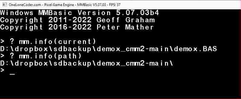

Posted: 11:34am
07 Mar 2022
Back in the land of sanity (I hope), is MM.INFO$(PATH) not implemented ?
Posted: 12:11pm
07 Mar 2022
Pluto
MM.INFO$(DIRECTORY) may help??
Posted: 12:14pm
07 Mar 2022
  Pluto said  MM.INFO$(DIRECTORY) may help??
I'm afraid not.
MM.INFO$(DIRECTORY) returns the current working directory (like CWD$ but not identical in all circumstances).
MM.INFO$(PATH) retuns the directory containing the currently running program, i.e. the parent of MM.INFO$(CURRENT).
Edited 2022-03-07 22:50 by thwill
Posted: 01:13pm
07 Mar 2022
mm.info(current) gives the current program with the full pathname. If I implement mm.info(path) do you want the final "\"?
Posted: 01:25pm
07 Mar 2022
  matherp said  mm.info(current) gives the current program with the full pathname. If I implement mm.info(path) do you want the final "\"?
Yes please Peter, because that is what the CMM2 does.
