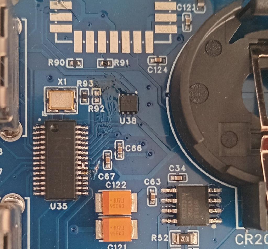

I've found a fault on the current PC3 design files (all boards so far made). This causes the ch334 hub chip to get hot, particularly if the programming cable and usb-c are both left plugged in and even when the switch is set to hub. Some time ago I swapped versions of the CH334 chip to use the CH334U as the previous variant had a bad batch at JLC.
What I hadn't understood is that this variant has an internal 3.3V regulator. It has two pins 20 and 21 marked 3.3V and 5V on the datasheet so that is how I connected them. What this means is that if the regulator in the CH334U is producing a higher voltage than the LM117 then the hub chip is trying to power the whole board and hence getting hot.
The correct wiring is either 3.3V on both the 3.3 and 5V pins, or 3.3V pin bypassed to gnd with 0.1 and 10uF caps. In addition R92 currently pulls up to 5V (only 10K so not serious) whereas it should pull up to 3.3V although there is an internal pullup so it is not really needed at all.
If the board isn't giving any issues then you can leave it as-is. If the ch334U is getting hot then you can mod the board as follows:
Cut the 5V trace to pin 20 between C67 and the pin. Short pins 20 and 21. Remove R92.
I will post revised gerbers shortly.

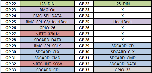

I'm looking at and comparing the schematics of the Pico Computer 3 and the PicoMite HDMIUSB motherboard V3.0.
I'm not entirely clear on the allocation of the RP2350B ports below the GP23 for connecting devices (SD card, Wi-Fi module, RTC timer signals).
If possible, could you explain the reasoning behind choosing these ports over the PicoMite HDMIUSB motherboard V3.0 ?
Why was the order of the SD card lines changed, why were these ports chosen for the RTC timer signals, and how does the SPI bus work for the Wi-Fi radio module?

I can confirm that matherp's fix for the hot USB chip problem worked on my one PM3 board that had that issue.  Future orders will make use of the updated gerber set.
