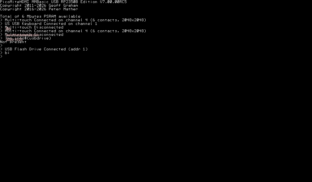

flip
Peter,
Thanks for the new features!
A couple of things with USB on PC2 with RC5
1) Minor (Petty) issue.
> ?MM.INFO$(USBDRIVE)
Not Present
Note the 2 prompts(also in screenshot below). It's a bit slow to respond after pressing Enter (could be because of checking the drive?)...reported just in case it hints at another problem.
2) A problem I have with Touch I suspect may have always been there, and could be in my setup - I have the 7" 1024x600 Touch module.
Until RC5 It did 2 connects with a single disconnect in between...I didn't report it as net effect was no problem. With RC5 it does 2 disconnects, rendering Touch inoperable as follows(Using the AMAZING PrintScreen feature!!):
(only tiny issue is that the forum doesn't accept bitmap so had to convert to PNG)...this is very minor.
Overall I am continually amazed ... thanks Peter
Regards Phil

I'm having trouble with an RP2040-PICO-PC.
I flashed "PicoMiteHDMIUSBV7.00.00RC5.uf2" and typed "option reset olimexusb" blindly using the USB keyboard. It had always worked before. Now I'm not getting any picture via HDMI.
Has anything changed? I haven't made any changes to the hardware, and it was working fine until the update.
Frank
