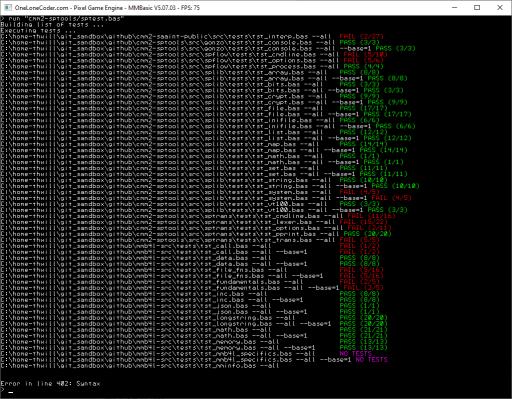

Starting to look pretty good with b4:
Notes:
1. I'm currently focusing on getting them all to run without crapping out ... which is what tst_mminfo is currently doing due to no OPTION SEARCH PATH being implemented.
2. Some of the FAILures are almost certainly false positives.
3. This is NOT a comprehensive set of unit-tests.

Your rodeo Peter. I think it should be implemented and I recently did so for MMB4L. As an argument if it were implemented I could then setup MMB4W so I could just type "*sptest" wherever I was in the file-system to run my unit-test suite recursively from that point. YMMV, but if you do implement it then please also implement the corresponding MM.INFO$(OPTION SEARCH PATH).

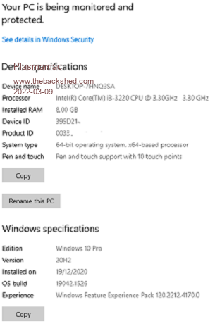

Posted: 07:32pm
08 Mar 2022
Plasmamac
Posted: 08:48pm

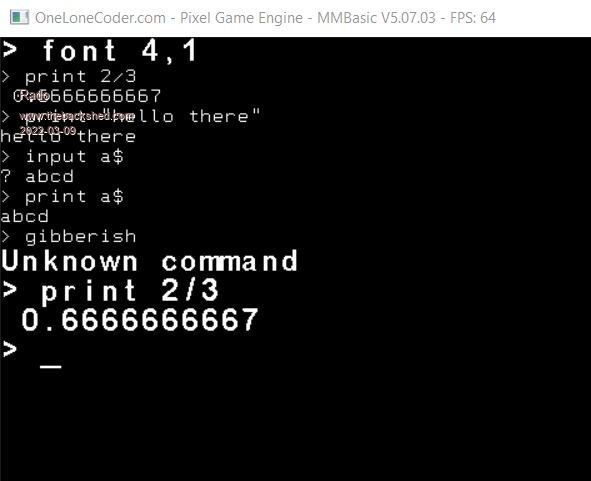

Rado
Just got some time to play with this (03.b5), and it seems that there's something with fonts: in command line, as soon as I enter something invalid the font reverses to default:
