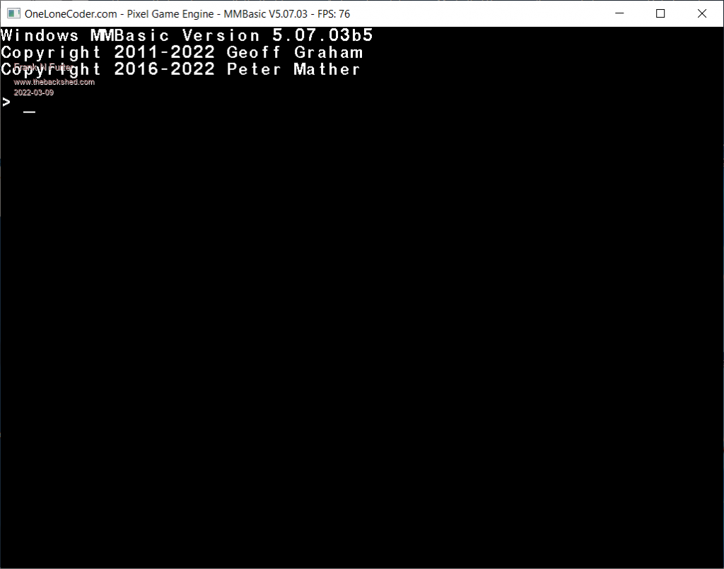

  Quote  Just got some time to play with this (03.b5), and it seems that there's something with fonts: in command line, as soon as I enter something invalid the font reverses to default:
This is intentional. There are lots of things you can do which mean the error message could be illegible (e.g. font of symbols). Therefore all errors default the font

You need to copy them to Windows/system32
What CPU do you have?
Damn Windows says that I have no rights to copy the files to System32 - even though I'm logged in as admin. The files are already there. Normally Windows takes the DLL's which are in the folder of the called program - even if they are already in System32...
The processor is a Intel I7.

Frank
Are you going to be online for a while? If so I'll post some hack versions for you to test to see if we can isolate the problem

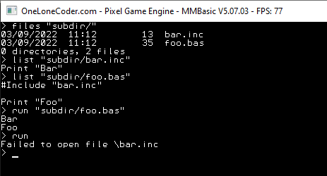

5. This one has been getting on my goat too and I've finally managed to reproduce it simply:

Thanks for your effort! I am online.
Frank
Posted: 11:52am
09 Mar 2022
Frank
Please try the attached. Current version but with audio disabled
ForFrank.zip
Posted: 12:01pm
09 Mar 2022
Frank N. Furter
This version works!!!
Frank
Posted: 12:35pm
09 Mar 2022
OK so we know it is the audio dll which is the problem - winmm.dll
Now please try the attached but launch mmbasic from a dos box using the command
MMBASIC 0
MMBasic.zip

Ok, with "MMBASIC 0" it works, without it does not work.
Frank
Posted: 01:49pm
09 Mar 2022
  Quote  Ok, with "MMBASIC 0" it works, without it does not work.
The only difference is that with the 0 I don't enable audio. That confirms the issue so you will need to find a version of winmm.dll that works and get it into the correct place or just do without audio (I'll leave the 0 parameter in place permanently) . I can't help any further - sorry
