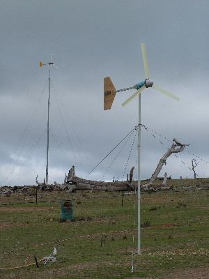

Mill TWO on its lovely new high tower was spinning faster
than mill ONE, good.
NO, yes mill TWO was spinning faster but was not making
any power?
(Mill TWO is considerably quieter than mill ONE even
going faster).
Mill TWO produces more power in high
winds than Mill ONE however the old mill starts producing
earlier and is better in light winds. We suspect that
one is in delta and the other is in star.

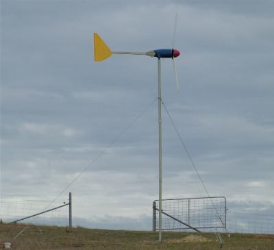

We observed that mill ONE tended to hunt around with
the wind, to be expected at only 4.5m above ground and
so low on the hill.
But it also seemed to start furling early and not maintain
output in strong winds.
The basic geometry of the tail is wrong,
in moderate winds the thrust on the blades allow the
mill to turn slightly away from the wind (as if starting
to furl)
The tail is not holding the mill into
the wind.

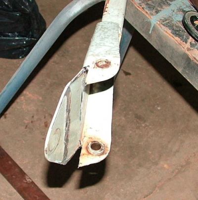

Mod 1. - Bend the tail arm 10
degrees away from the axis of the wind mill.

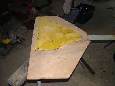

Mod 2. – Added %50 more
weight to the tail. Changed metal tail for a piece of
ply wood twice the area and heavier. (at present we
are only 0.5 kg heavier than the original vane but could
do with more weight)
RESULTS, mill ONE is more stable in
moderate winds and is holding a higher output in gusty
winds during furling operations.
Picture of mill ONE, before tail mods.
Checking the tail angle.
Hold the tail arm against the stop on the housing and
sight along the axis of the generator. The tail should
move away from the axis by approximately 10 degrees
You can see how Dave (my
brother) cut the tail arm to get the added 10 degrees.
Just weld a filler in the slot and a splash of paint
if you are so inclined.
The tail size
The tail was cut from some
scrap ply in the shed. I think it was 7mm thick
Pic of the 2 mills, mill
ONE is in the fore ground.
