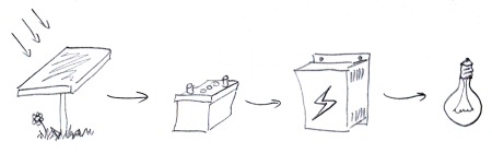

A off grid installation consists of a few basic components that work together to provide you with usable power. These components are usually rated in Watts or Amp hours. How do we work out the sizing of these components?
We have our power source, and this could be solar, wind, hydro, a generator or even grid power. Then we have a storage system, usually batteries. An inverter to convert the stored energy into a more versatile forum, AC. And lastly the load, what we use the power for.
There are many other components, like charge controllers, fusing, etc, but we don't need to worry about those for this exercise.
