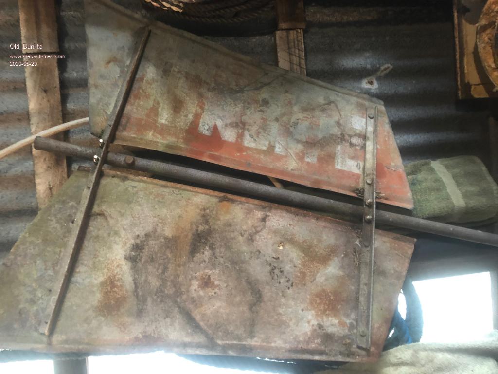

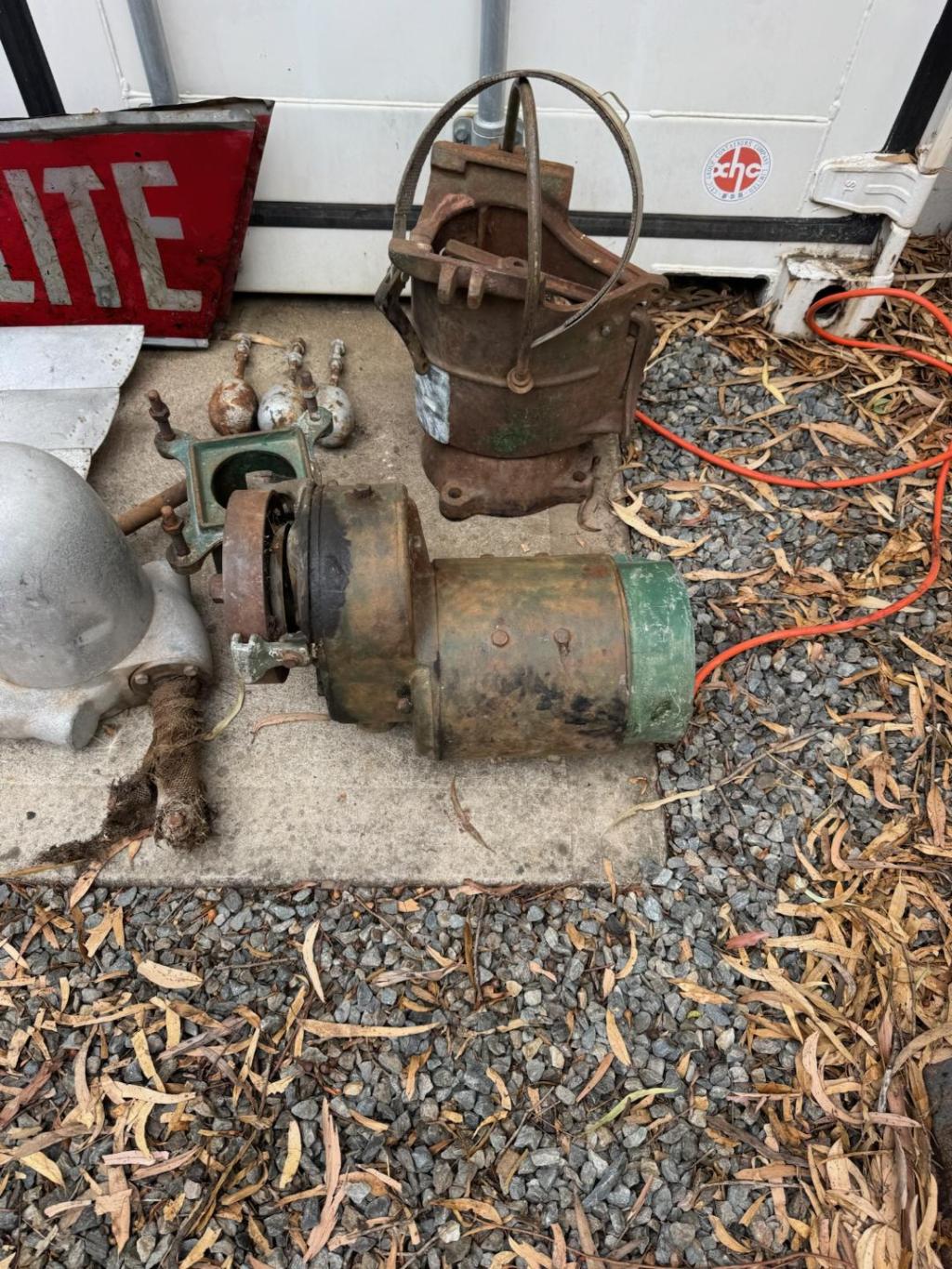

  GleamBright said  Hi, new member here with a DIY off grid solar system in development and construction, reading this post about Dunlite turbines with much interest.

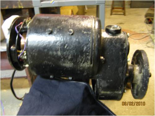

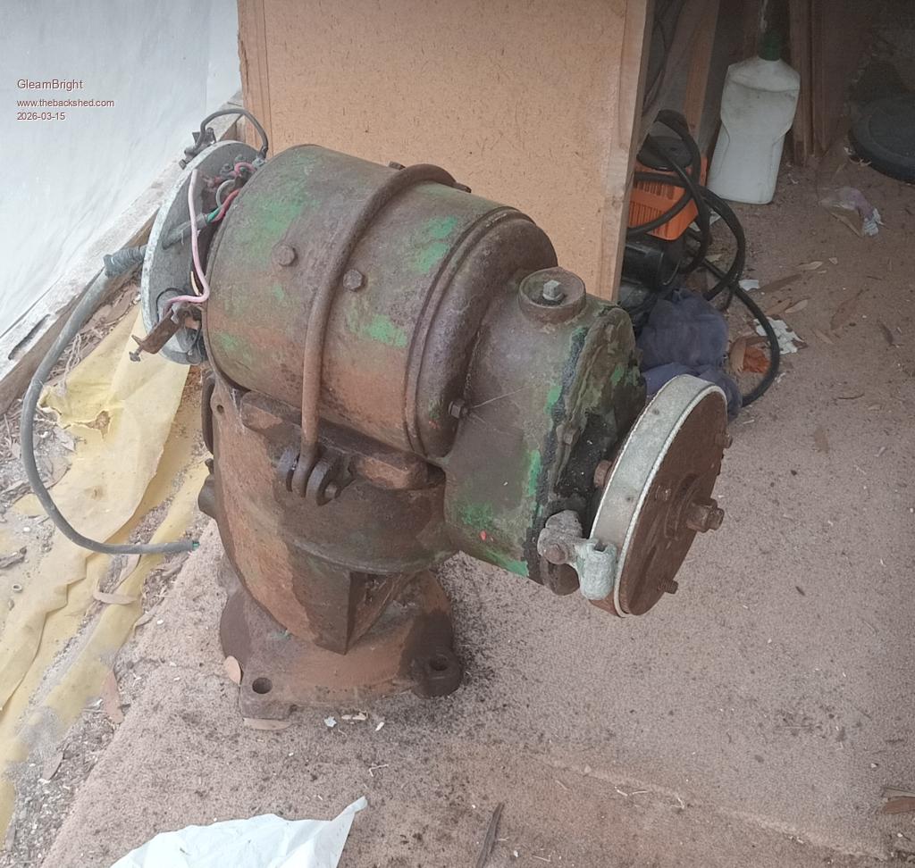

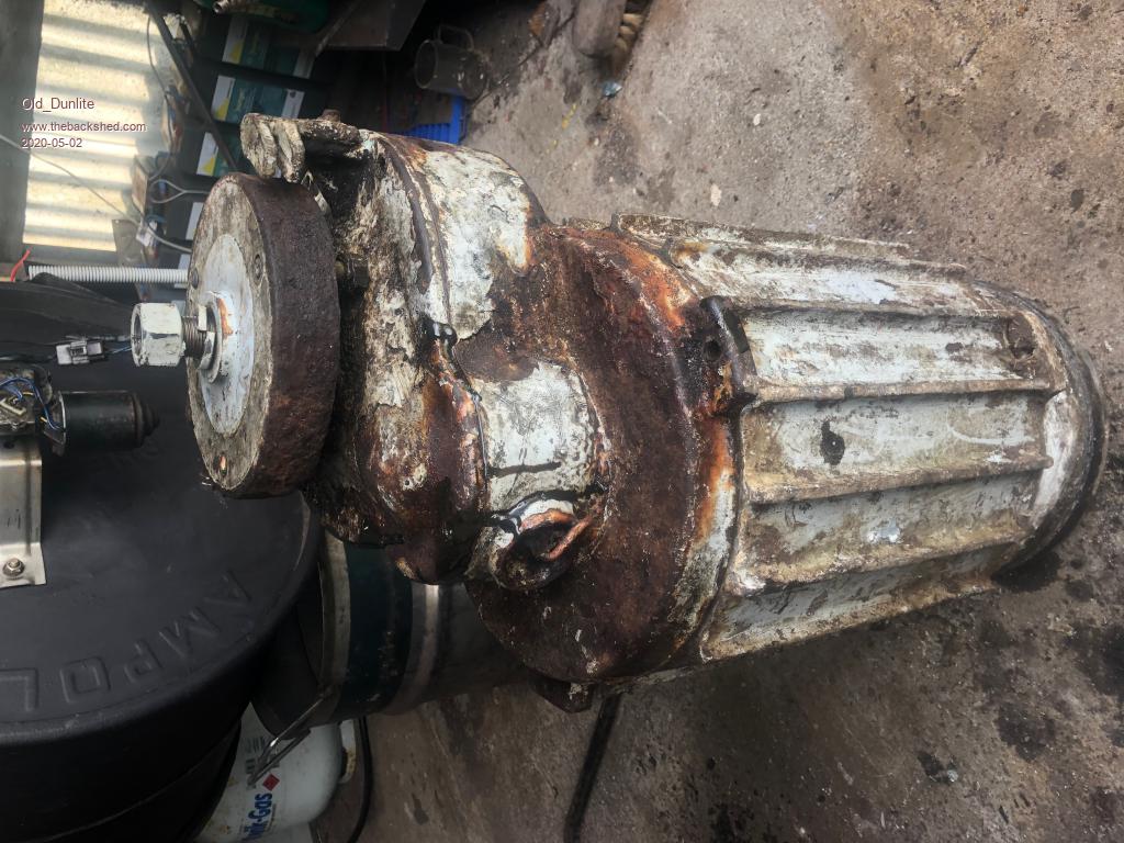

I'm about to acquire a refurbishable model M Dunlite Generator at near scrap value, as per attached images, and am piecing together what needs to be done to restore to runnning order. There is also a spare Model M generator, two 750W generators, and various 3 and 4 hub and blade assemblies in varying states of repair, generally poor. On top of this, I will looking at acquiring an L model 48V unit, with tower, in good condition, soon, but I'll start with the pictured unit. Two main issues:
1. The voltage regulator is missing. I refer to a previous quote on this thread by 'b251367'
"The models L and M have a single field winding which is shunt connected via a voltage regulator. .... I have just developed and built a voltage regulator, very simple and low tech. It is just solid state version of the old mechanical regulator and uses a large diode to prevent reverse current."
2. While resistances will be checked on receipt, the owner tells me it was a 32V unit whereas I am designing a 48V system.
Can I get some guidance on how to proceed to reinstate the voltage regulator and convert to 48V?

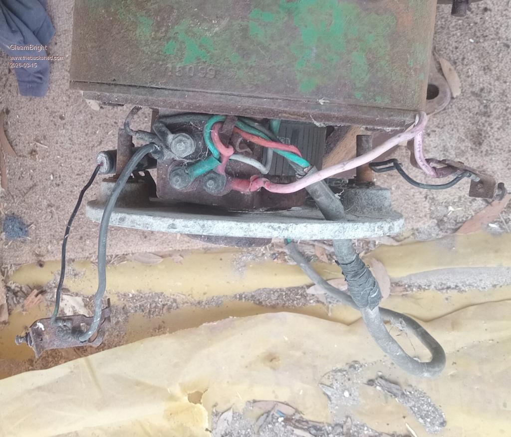

Phil99 Yes, that is the commutator and it's in good condition/ hasn't been machined. The entire unit 'got away from' the seller when lowering the tower: it fell, damaged the blade tips and has been sitting idle since. The rest of the unit is largely intact, including the blade hub and counterweights. It needs a main bearing replacement.
Old_Dunlite you have a big task ahead, based on the condition of your units, and I'm happy to collaborate.
A commutator rewind is probably overkill if a step up transformer would do the same job albeit at a small loss of efficiency.

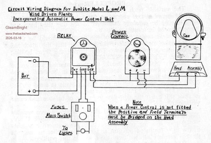

Attached below is the wiring diagram from the operating manual. My understanding is that a PWM controller and diode would replace the power control unit and relay as described. In the original unit, the relay is a combined 'selenium dry rectifier' (older equivalent of a diode) and the power control unit is a mechanical PWM device. I'm just not sure what PWM or diode specs to order, nor how to wire/configure it correctly.

A transformer isn't going to work as your unit is d.c.  (looking at old-dunlite's pics though makes me think that his unit is a 3phase alternator, which could be transformered to a different voltage).
I don't know anything about these units, but is a 32v unit is designed to operate on a 32v battery or just output 32v? Or is it designed to charge a 24v up to 32v?
Similarly for a 48v unit? Although i would tend to assume a '48v' generator is designed for 48v battery charging - i.e. up to 60v.
But taking the 32v and 48v at face value, that means you need to get an output 1.5 x design:
If the original blades were a low speed design, then a faster blade set might work.
Running the field winding at 1.5 x 32v (i.e. 48v) would mean field amps are 1.5 x nominal too. Assuming this doesn't drive the iron into saturation, that would raise the output voltage to 48v. But, it would also raise the winding power to 2.25 x nominal. Without knowing the field resistance (and therefore nominal power at 32v) it's difficult to say if that would overheat the generator of not.
Building a circuit to replace the original controller shouldn't be too difficult, particularly as your diagram suggests running without a controller is an option, but would need to know details such as field winding resistance, and max output amps.
Posts: 3453
Posted: 02:45am 16 Mar 2026
On old generators the stated voltage is the nominal battery voltage, not the charging voltage. So for a 32V unit the output would be 35 to 37V.
In the diagram above the Note says if no Power Control (voltage regulator?) is fitted the field can be directly connected to the output.
This opens up an opportunity as the DC to DC converter can do the regulating, so the generator output voltage no longer matters.
Same as a solar charger where the panel voltage can vary a lot, except using a boost instead of buck converter.
The Relay (reverse current cutout) would be replaced with a large diode. Either a Schottky or MOSFET Ideal Diode circuit for better efficiency.
Edited 2026-03-16 12:54 by phil99

The manual states the following for the L and M models (this one is an M):
                    Model L (1 kW)     Model M (1.5 kW)
Normal Voltage       32     50          32     50     110
Maximum Voltage      50     66          50     66     145
Maximum Amperage     20     15          30     23     11
and from earlier in this thread, resistances for the L model are:
32 volt machine: Field 27 ohms, Armature 0.4 ohms
48 volt machine: Field 50 ohms, Armature 0.6 ohms
No resistance data available for the M model although it could be inferred? knowing that the only mechanical difference between the L and Models is the gearbox ratio (3.5:1 vs 5:1 respectively).
Which answers the question: there is plenty of voltage to accommodate charging voltages substantially higher than nominal.
re: running at higher speeds, the manual emphasises in upper case: 'MAKE CERTAIN THAT THE MAXIMUM CHARGE RATE IS NOT EXCEEDED', and the blade hub incorporates an (adjustable) variable pitch mechanism, with instructions to adjust the pitch governer to limit blade speed to achieve this end.
I couldn't see a faster blade set as viable: they're a low speed design formed from sheet metal, and operating at higher speed would increase the risk of overspeed failure during high winds - this is mentioned in the manual.
Edited 2026-03-16 17:04 by GleamBright

Given the warning in capitals and that the governor is how the the current is normally controlled, another means will be needed if you override that.
So instead you will need a voltage regulator that includes current sensing and regulation.
Early Holdens eg. EH had a Bosch 12V 25A generator with a regulator box that had 3 step proportional relays for both voltage and current, as well as the reverse current cutout relay.
You will need a solid-state equivalent of that.

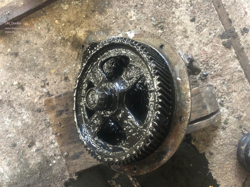

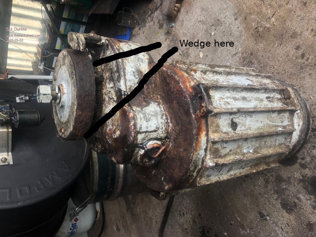

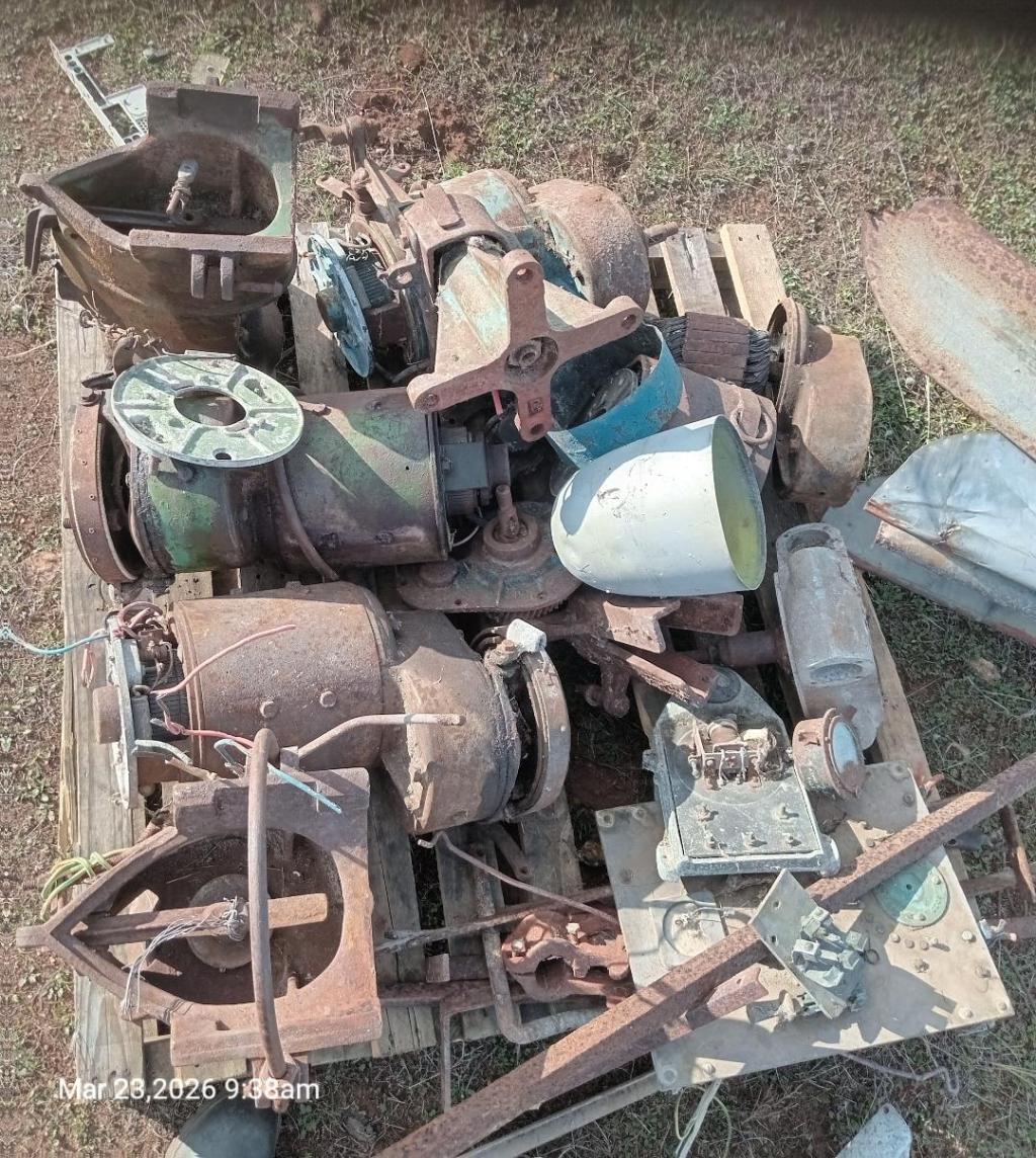

Some piccs of the haul & a quick inventory take:
- 1 x functioning 50V L model, with tower
- 1 x near functioning 36V L model, requiring refurbishment and new blades
- 1 x spare 36V L model with components in various states of repair
- 1 x near functioning 36V 750W model, requiring refurbushment
- 1 x spare 36V 750W model, also with components in various states of repair.
I want to see if I can upgrade the L models to 1500W. To do so, Old_Dunlite or anyone else, would you consider parting with your 5:1 gearbox drive pulley (&shaft) if you're not looking at completing your own project in the foreseeable future?
Edited 2026-03-23 17:09 by GleamBright

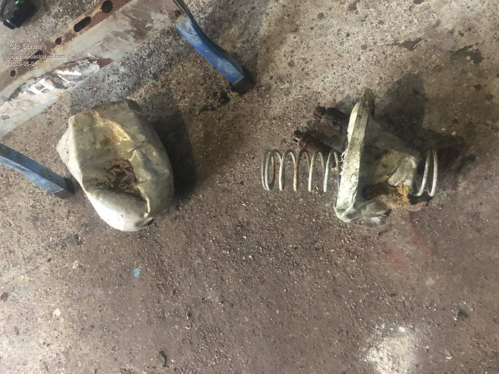

  GleamBright said  Adrian, is there any chance we could get copies of said reports and are there recommendations to improve the stability of the pitch control on the Dunlite systems?

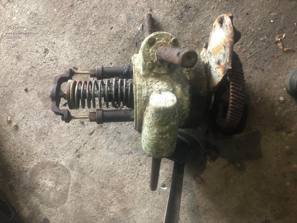

All the reports I referred to are free public report which you can find on my website: www.kdwindturbines.nl at the menu KD-reports. To know about which subjects I have written reports, I advise to read the note: "Sequence of KD-reports for self-study" given at the top of the list with KD-reports.

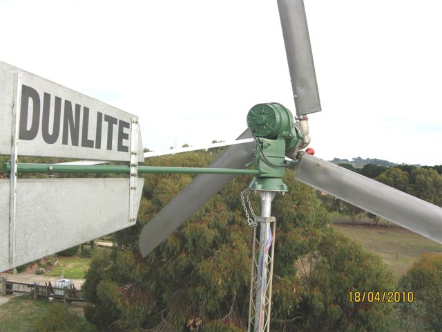

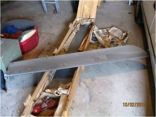

In the photo of the Dunlite you can see that there is an eccentricity in between the blade axis and the rotor axis. Assume that this eccentricity is called e. You can also see that a centrifugal weight is mounted at the end of an arm which is directly coupled to the blade. Assume that the distance in between the centre of gravity of the weight and the blade axis is called L. Assume that the angle in between the arm and the rotor axis is called gamma. The centrifugal moment which is produced bij the weight depends on the ratio e / L and on gamma.
Chapter 14 of KD 437 is called: "Adding of a centrifugal weight to the blade". In this chapter, formula 43 gives the centrifugal moment Mc. This moment has been determined for four different ratio's of e / L and also for e = 0, so for the situation that the blade axis intersects with the rotor axis. The result of the calculations is given in table 6 and figure 8. Figure 8 is very illustrative. If e = 0, the maximum of the curve lays at gamma = 45°. If e = L, the maximum of the curve lays at gamma = 30°.
The pitch control system is only stable if it works symmetrical around the maximum of the curve. For the Dunlite the arm L is rather short with respect to the eccentricity e. So lets assume that e = L and so we have to use the upper curve of figure 8. Assume that the total blade rotation of beta is 30°. So this means that we have to start with an angle gamma = 15° for the normal blade angle beta and that we have to end with an angle gamma = 45° for the maximum blade angle beta. In tabel 6 it can be seen that the values which is given in between brackets in the used formula varies from 2.4319 at gamma = 15° up to 2.5981 for gamma = 30 and up to 2.4142 for gamma = 45°. So the variation is only little. The counterbalancing moment which is supplied by the central spring also increases and how much depends on the spring stiffness. If the spring moment increases more at gamma = 15° than the centrifugal moment, the system will be stable.
However, in the photo of the Dunlite it can be seen that the arm of the centrifugal weight is about in parallel to the rotor axis for the normal blade angle. This means that gamma = 0°. In figure 8 it can be seen that now we are at the start of the curve and so once the blade starts moving, the moment increases strongly. This is the cause of the instability.
The stability of the system is also influenced by the bearing friction. A sensible functioning can only be obtained if the bearing friction is very small and this requires that ball bearings or roller bearings are used for the rotation of the blade around its axis. I don't know what bearings are used for the Dunlite. If sleeve bearings are used, there will be a lot of hysteresis in the blade movement.
For the pitch control system as given in KD 437, the centrifugal weight is positioned behind the rotor (see fig. 7) and for the Dunlite it is positioned before the rotor.  But the position of the axis of the blade with respect to the rotor axis is different and for both systems, the centrifugal force results in increase of the blade angle. Figure 8 out of KD 437 is therefore also valid for the Dunlite.

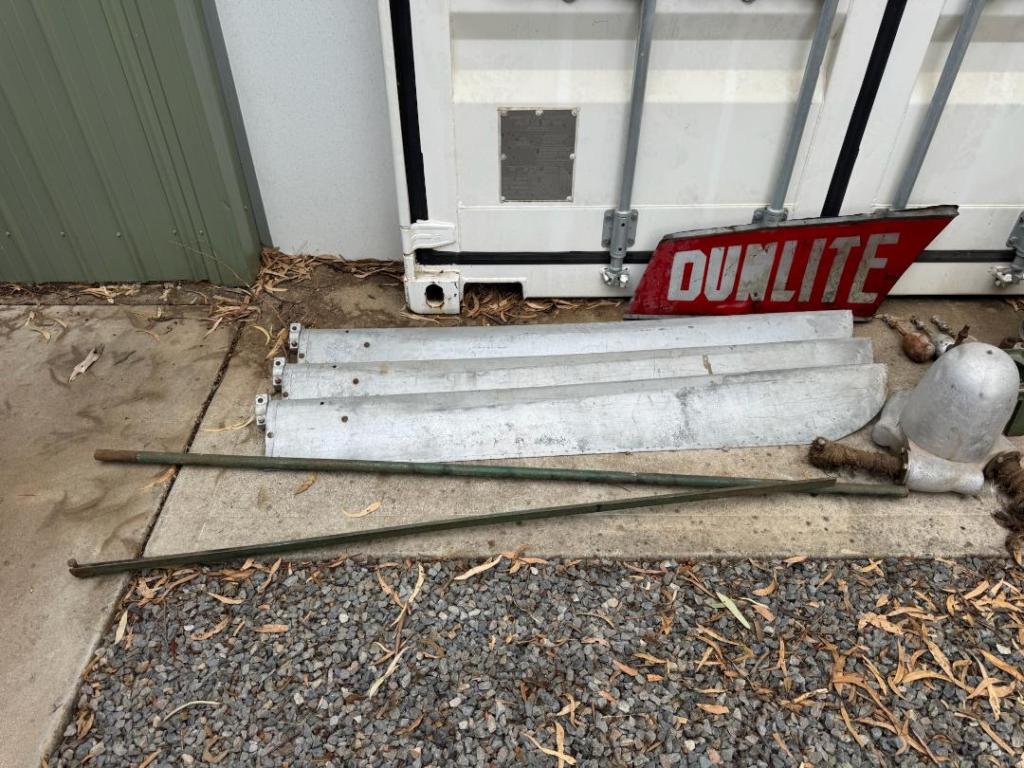

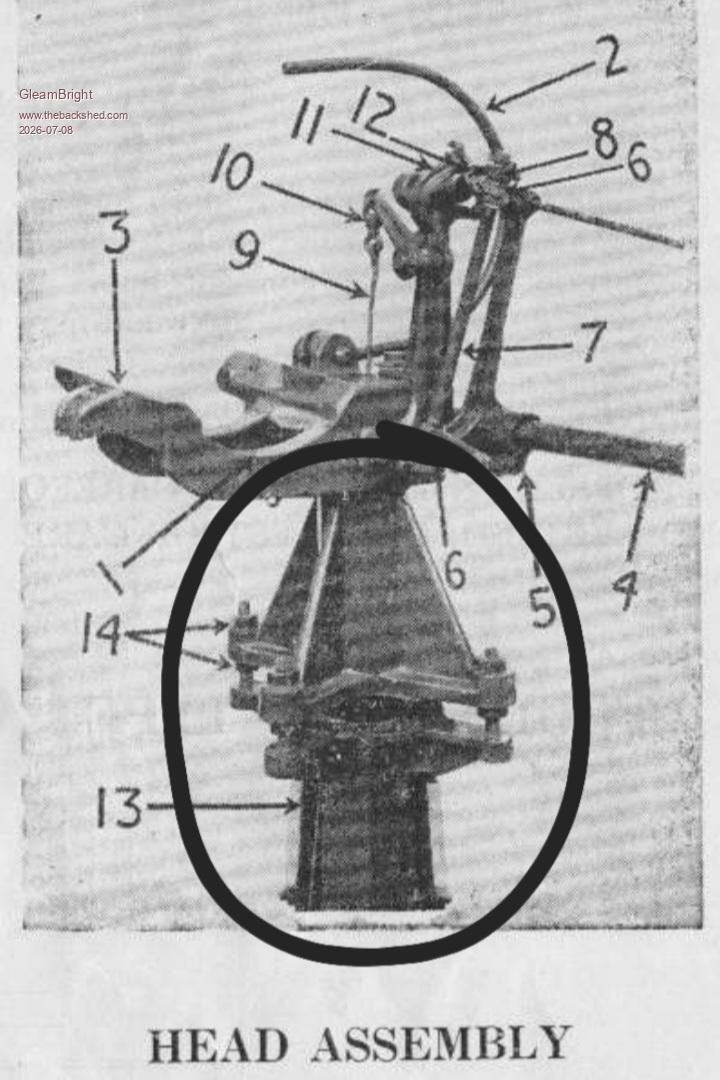

I'm now looking for one of these (head & head casting for a 750W 4 blade unit). Does anyone have one available in Australia? Presently evaluating refurbishment options for two of these, the base of one of them was broken after a fall from its tower and is the only part that I'm not confident enough to fabricate and/or repair.
