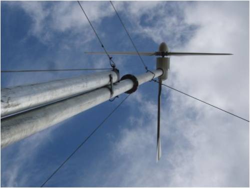

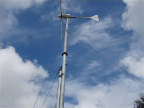

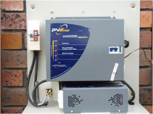

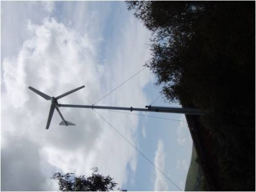

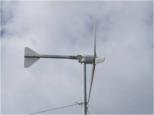

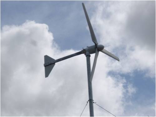

Bolty
Joined: 03/04/2008
Posts: 81
Posted: 01:08am 13 Oct 2008
The turbine is a nominal 48 volt which matches the PVE 1200 very well. The controller is the recently released Latronics TC48. This couples well with the PVE and applies PWM braking at 75 volts, which is very close to the turbine producing the inverter power limit of 1200 watts. So far I have been very pleased with the controller. It has a large inbuilt bank of capacitors of 0.1 Farad. This has the effect of keeping the system ready and it seems to be able to hold the inverter synchronized to the grid for up to 15 mins, without the turbine generating the necessary 55 volts to input power. I have observed no wind activity for 10 mins, then a wind gust feeds to the inverter immediately. The $2238 cost for the inverter included the controller and the Latronics weatherproof box.
I have downloaded some pictures that hopefully come through OK!
Cheers!
Bolty

Bolty
Joined: 03/04/2008
Posts: 81
Posted: 10:36am 13 Oct 2008
Hi Ken!
The noise levels are really low. I have no dB readings!Our bedroom is only 4 metres from the tower, and we can only ever hear a very slight hum at a certain rpm. The wind noise associated with the turbine is virtually inaudible, except when the wind changes direction when a feathering type of sound can be heard. When the electronic brake activates, it produces a very short but pronounced vibration through the pole for about 1 second. It is however not loud enough to wake us! My wife was a little concerned about the location initially, but neither of us are effected by any noise.(No we are not deaf)
KarlJ
Glad to see that you have been able to modify the spreadsheet to take into account the low and high limits. I suspect that you should limit at 10 m/s, as furling should occur somewhere near that value. However with your data, it is not going to make a great deal of difference to the total Kwh.
A good idea to go back to 30 sec intervals!
The 3 phase bridge rectifier is in the Latronics box, and should be able to be seen in the photo at the bottom left, below the circuit breakers that act as a brake. The cable came with the system, and is about 4mm2 copper. It is about 10 metres long, and I have not yet cut it the shortest possible length (to minimize losses)
I have observed the turbine producing 1200 watts at the point of furling!
Overall I have been very pleased with the quality of the whole system. Everything is very well built and overkill for strength. As an example, the provided guy wire cables are 8mm galv.
I trust that your 2 Kw system will soon be providing clean green energy!
Good luck!
Bolty
