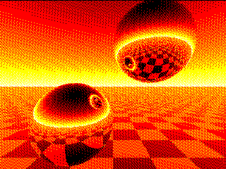

Posted: 09:49pm 21 Feb 2026
Spheres
MODE 2
Map(1)=RGB(Red)
Map(2)=RGB(Yellow)
Map(3)=RGB(White)
Map set
For N=0 To 239
For M=0 To 319
X=0:Y=-.1:Z=3
U=(M-159.5)/160:V=(N-117.5)/160
W=1/Sqr(U*U+V*V+1):U=U*W:V=V*W
I=Sgn(U):G=1
 E=X-I:F=Y-I:P=U*E+V*F-W*Z
 D=P*P-E*E-F*F-Z*Z+1
 If D>0 Then
  T=-P-Sqr(D)
  If T>0 Then
   X=X+T*U:Y=Y+T*V:Z=Z-T*W:E=X-I:F=Y-I:G=Z
   P=2*(U*E+V*F-W*G):U=U-P*E:V=V-P*F:W=W+P*G:I=-I
  EndIf
 EndIf
 If V<0 Then
  P=(Y+2)/V:V=-V*((Int(X-U*P)+Int(Z-W*P)And 1)/2+.3)+.2
 EndIf
 Color Map(3-(48*Sqr(V)+(7*(M+4*N))Mod 16)\16)
 Pixel M,240-N
Next
Next
