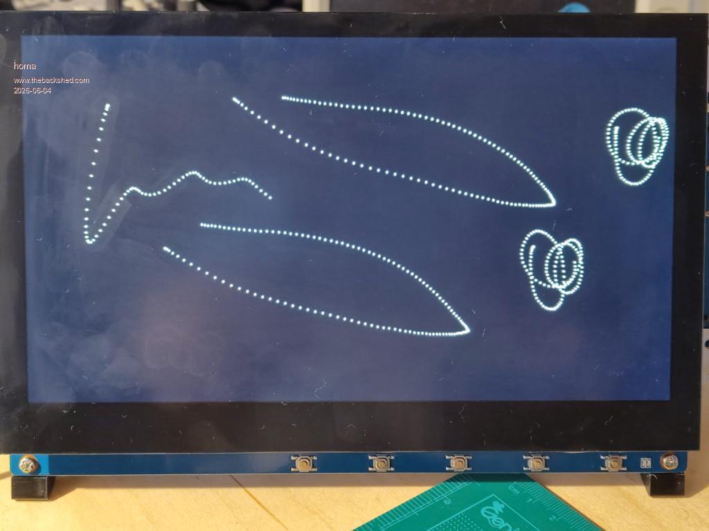

homa
Joined: 05/11/2021
Posts: 724
Posted: 08:23am 04 Jun 2026
Peter,
At first I was put off by WhiteWizzard’s report, but I gave it a go anyway.
The result is that initially there’s no debug output either, and the “gui test touch” command clears the screen but doesn’t respond to it.
However, I noticed that after a reset and a quick, immediate "gui test touch", there is a brief window during which the screen responds to the test. After that, though, it stops responding. Only a RESET causes the behaviour to reappear, so it is reproducible.
Attached is an image showing single-touch and two-finger-touch.
Matthias
Update: I can even reconnect the Microsoft mouse/keyboard dongle without a Hex Debug message appearing. However, the behaviour remains the same. The pump demo works via touch for a brief moment, then there is no response again. After that, it only works with the mouse.
Edited 2026-06-04 18:30 by homa
Posts: 12058
Posted: 08:30am 04 Jun 2026
Matthias
I'm unclear what you are reporting. Is multi-touch now working but stops after a period? Does single touch also now stop when it didn't before?
This version should have the debug
PicoMite.zip
Edited 2026-06-04 18:35 by matherp

Peter,
1. RESET
2. Output:
PicoMiteHDMI MMBasic USB RP2350A Edition V6.03.00RC16
Copyright 2011-2026 Geoff Graham
Copyright 2016-2026 Peter Mather
> Multi-touch Connected on channel 4 (10 contacts, 16384x16384)
> GR USB Keyboard Connected on channel 1
> USB Mouse Connected on channel 2
3. gui test touch <--- immediate entry
4. You have about 5 seconds to test the touch, whether single or multi-touch! After that, only the touch function stops working. The Pico can still be fully operated via the terminal.
5. goto 1
Matthias
Footnote added 2026-06-04 18:35 by homa
With the RC15, the touch operates in single-mode throughout!
