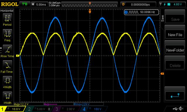

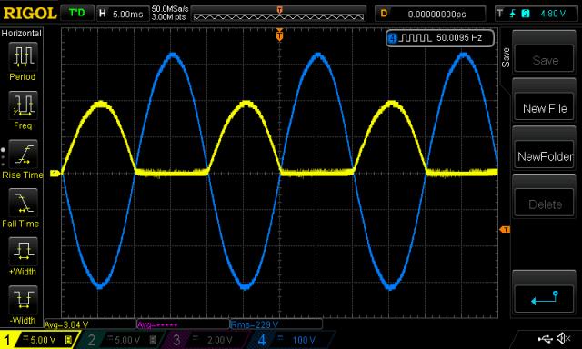

Tinyt:
the AC to be sync'd signal is sent through a full bridge rectifier.
It gives a rising edge interrupt each 1/2 cycle.
I don't like there is no way to tell which 1/2 cycle caused the interrupt.
The nanoverter will sync at randomly chosen times 0 degrees and 180 degrees
with respect to the AC sync input.
If you use a single diode then things become feasible.
There is one rising edge only every full cycle.
full bridge:
single diode:

  poida said   Tinyt:
OK, now I understand. Attached schematic for review now has a single diode.2018-11-19_114141_NANOVERTERdraft4.pdf
poida
Joined: 02/02/2017
Posts: 1497
Posted: 02:26am 19 Nov 2018
Tinyt:
I have sync working now, with breadboard single diode sampler.
There is so much noise on this input to pin D2. I placed a 22nF across it to ground at the pin input.
see the video
first I hold reset to show no sync.
Then the code runs and is on standby.
While on standby, the sync code aligns output to sync pulses
Then I press ON, for AC output. This sometimes upsets the sync but it is regained.
There is a small phase error, this is a puzzle to explore later.
Yellow is pin D2 input
White is my street power
Light Blue is inverter AC output.
My Uno seems to have clamp diodes of about 7V.

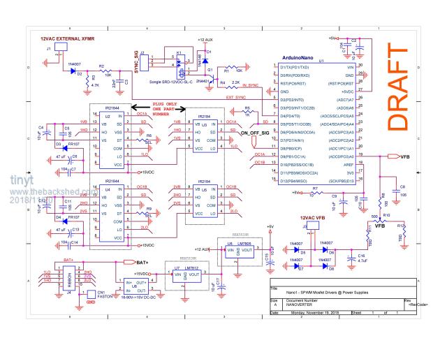

wiseguy
Joined: 21/06/2018
Posts: 1326
Posted: 10:23am 19 Nov 2018
  tinyt said
Attached is revised schematic for review/comments/etc. 2018-11-19_040352_NANOVERTERdraft3.pdf
I have removed the opto sync circuit and retained the isolated transformer circuit with changes.
Good work TinyT, not sure why but are some of the bussed connection lines invisible or they are not meant to be seen ? ie OC1A and OC1B pins from the micro appear to join an invisible buss?
Are VB & VS on U3 & U2 meant to be linked to share the bootstrap parts (same for U5,U4). Or is having the same net name all that's required. Also the Net on the connector J3 for 2VS is mislabelled as VS2.
Comment, the IR2184 has ~ 500nS deadtime the IR21844 has 400nS - 5uS - I see its main advantage is winding back deadtime to 400nS I cant imagine ever needing more than 500nS - in my past experience anyway.
Edited by wiseguy 2018-11-20
Cheers Mike
tinyt
Joined: 12/11/2017
Posts: 564
Posted: 04:01pm 19 Nov 2018
  wiseguy said  ...
I checked the pdf and the bussed connection lines look good to me. I am using Orcad 16.3 schematic capture (old like me). When it creates a net list for PCB layout, it uses the net name of the connection i.e. OC1A, SD, VB, BAT+, +5V, etc. If a connection has no net name it creates its own to complete the net list. The buss symbol is not used for net list creation and is just a visual aid for me instead of just leaving a connection end hanging.
Yes, in the schematic the intent is for all net names like VB to be connected together. Very often I make a mistake like EXT_SYNC and EXT-SYNC, they will not be connected in PCB layout. There is a Design Rules Check tool, but sometimes I forget to do it.
Somebody mentioned using IR21844 instead of IR2184, so the schematic supports both. Just make sure they are not mixed on the board.
Here is updated schematic for review/comment. 2018-11-20_020531_NANOVERTERdraft5.pdf I have added a relay driven by the nano D4. The ribbon connector pin 6 net name is also corrected, thanks wiseguy.
Here is jpg also to compare with the pdf.

Tinyt:
thanks for the schematics.
I would like to add a small thing, a jumper to connect D2 (INT0) to ground.
This is to most certainly and under all circumstances prevent sync pulses entering the uC. The jumper will be the enable/disable sync control.
Could I have also, a note "C3 to be mounted close to U1 pins 4,5"?
C8 might also be placed close to pin 19 (ADC ch0) with advantage.
What do you think? There is incredible amounts of high frequency noise near inverters.
Maybe a LED to show sync status? This is up to you, I don't mind.

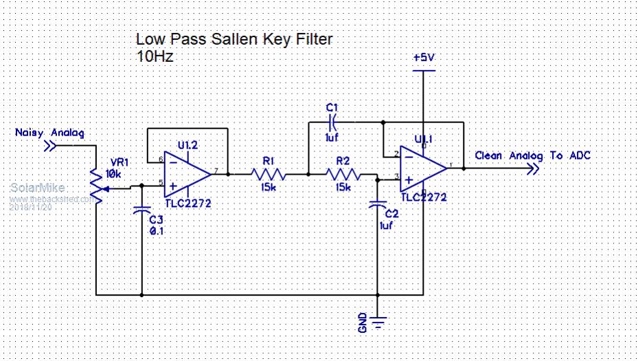

Solar Mike
Joined: 08/02/2015
Posts: 1255
Posted: 12:20am 20 Nov 2018
Poida, it adds to complexity but a decent low pass filter on all CPU ADC inputs has a number of advantages, (1) removes all noise, (2) presents a very low impedance source for the ADC and any subsequent other monitors of the voltage value.
I don't bother measuring mains volts via a transformer anymore, just sample the battery volts instead, these inverters are so over spec'd that the core has extremely good regulation, so mains AC voltage is a direct reflection of the battery value.
Mike
