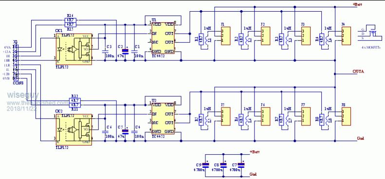

tinyt
Joined: 12/11/2017
Posts: 564
Posted: 02:56pm 20 Nov 2018
  wiseguy said   TinyT, something quite minor, net 1VS is missing from U2 pin 11. I assume all the unused pins on the nano have internal pullup/downs as required ?
Perhaps pin 11 should have a pull down in case of input disconnect, will fail safe.
(or is there an internal pull down ?) Rest looks good.
I still dont get what is happening with the buss wires on the PDF's I have tried 4 different PDF viewers and none show me the bussed wires - I now give up - I dont need to see them, just not sure why I cant.
Thanks wiseguy, that missing 1VS net is not a minor mistake. I don't intend to manually route the pcb, it will take me forever to do it. I will be using spectra autorouter and if that net name is not there, U2 pin 11 will not be connected to the 1VS net.
The IR21844 data sheet typical connection does not show an external pull down on the VS pin, but I added them (2 resistors won't occupy much space and just don't install if not needed).
I think I now understand the missing bus wires that you are looking for, look at the ribbon connector pins (wide blue lines?). Are they the ones? If they are, I did not add them as the drawing now is crammed and busy.
Attached is the revised schematic for review/comment. 2018-11-21_005308_NANOVERTERdraft7.pdf. I also removed decimal points on values as requested by tinker.

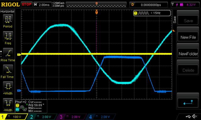

Tinyt:
I would like for you to add an opto coupler between the AC sync output and D2.
I found in testing that there was so much noise, the voltage divided sample of the AC sync contained huge spikes from the PWM.
These spikes upset the edge trigger of INT0 to a large amount.
The source of the noise is numerous poorly routed ground wires, ground loops,
un-shielded wires everywhere, and your-guess-is-as-good-as-mine ground reference.
pink is INT0 trigger
Dark Blue is AC sync volts into D2 (INT0)
Light Blue is street AC
Yellow is nanoverter AC, if present
First is sync'd up, AC sample voltage into pin D2
This is how I developed the sync code, using v1
next is with the inverter ON. Noise...

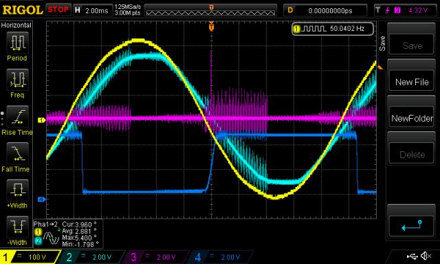

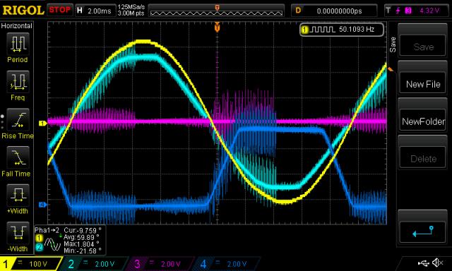

Notice the horizonal shift in trigger point, the center line.
And so much vertical hash on the input.
v1 code could barely run, v2 with PID control was unstable.
When testing v2 PID sync code with a clean trigger signal, all was OK.
But once you switch the inverter on, things go bad.

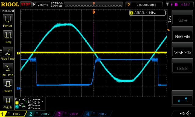

Now with the optocoupler (TLP523-2, something I had handy)
Inverter OFF, clean and fast trigger signal, eh?
I used the 10cm long earth leads for the DSO probes for the first 3 images.
These CRO probe earth leads are well know to be good antennas at RF, and add about 5uH to the measurement too.
On the last one, I used the tiny spring wire earth to minimise the RF uptake.
I placed the earth wire on pin 5 and the probe tip on pin6 of the TLP523-2.
This is the lowest noise probe method I can achieve and closely reflects what the
uC sees on it's pin.
One inch leads connect the opto's outputs to ground and pin D2 - which probably
pick up some noise.
And with the inverter ON.
No hash on the trigger input, and no time offset added from false triggers on the hash.
I will adjust the PID setpoint for sync, to align the inverter output to sync input later tonight.
I think we will have a challenging fight against noise on all the inputs of our project. Maybe I have won round 1.

I follow a similar philosophy to Warp when it comes to high power stages and isolate as much as possible from the control board. Although it is unproven at this stage I decided to share my inverter approach to minimise noise from the output stages reaching the control board.
My power output stage PCB's (2 required for a full bridge) will have 1 leg of the bridge per PCB Each Leg of the bridge will have 4 x FETs in parallel. The upper FET drive stages each have an isolated 12V supply to power the gate driver ICs which are fed by opto-coupled inputs.
Another isolated supply drives both the lower FET driver stages on each PCB as they will share a common Source Battery negative connection, and also have opto-coupled inputs.
The opto-couplers for each of the 4 sections of the bridge could be driven by 2 x IR2184's which have internal dead-time on the control PCB. Employing simpler drivers & using cross coupled optos as per Warps favored driving method for each bridge leg will provide both dead-time and high noise immunity.
As the 4 x bridge stages all have opto-coupled inputs and their power supplies are each isolated there is no direct electrical connection between the FET bridge PCBs and the control PCB - they are in effect galvanically isolated.
The control PCB has the small auxiliary power supply that provides the 3 x 12V isolated supplies. It also contains the nano and other support circuitry as per TinyTs circuit.
The only connection from the control board to the Power stage will be a ground connection to reference the battery voltage reading - and of course a high impedance resistor for the +Ve Battery voltage measurement. The result should be a very quiet control board environment with minimal noise pickup. If the output bridge was to go totally feral with fireworks etc nothing can pass through the optos or the isolated supplies to damage the control board. The 2 x output PCBs can be easily swapped out or repaired depending on the damage sustained..
For anyone interested here is the circuit - but use at your own risk, this is not intended as a proven project design - yet. I am waiting until Poidas software and the control PCB circuitry is a bit closer before sending them all out for manufacture.
2018-11-22_005206_Output_PCB_Sch.pdf
Schematic picture is a bit ordinary so PDF uploaded here
Edited by wiseguy 2018-11-23

Wiseguy:
Nice looking design.
