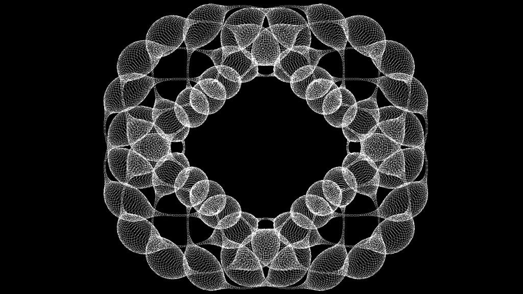

Posted: 03:26pm 27 Sep 2024

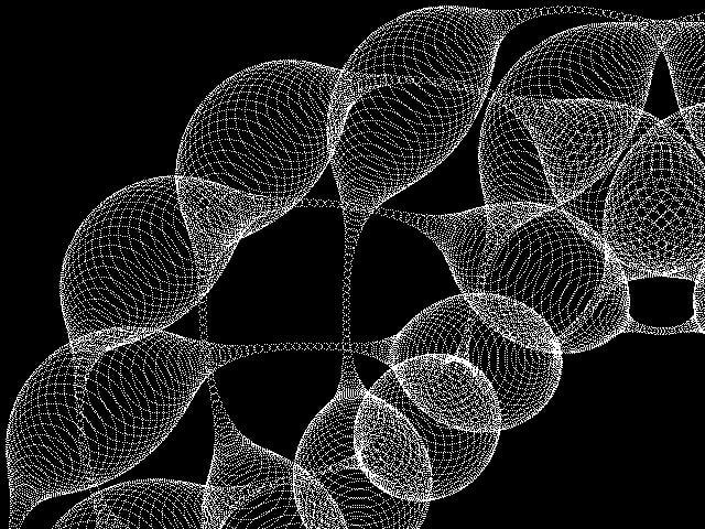

  Pluto said  An other beautiful creation!
T=3000
For L=1 To T
 A=10*Pi*L/T
 B=16*Pi*L/T
 X=600*Cos(A)*(1-.5*Cos(B)^2)
 Y=600*Sin(A)*(1-.5*Cos(B)^2)
 R=600*(.005+.1*(Sin((52*Pi*L)/T))^4)
 For K=0 To 2*Pi Step Pi/R/1.5
   Pixel 600+X+Cos(K)*R,600+Y+Sin(K)*R
 Next K
Next L

javavi
Joined: 01/10/2023
Location: Ukraine
Posts: 642
Posted: 05:18pm 27 Sep 2024
  Sasquatch said  Modified for HDMI Widescreen Mode 1
Edited 2024-09-28 03:22 by javavi

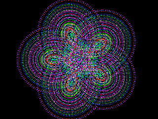

javavi
Joined: 01/10/2023
Location: Ukraine
Posts: 642
Posted: 05:35pm 29 Sep 2024

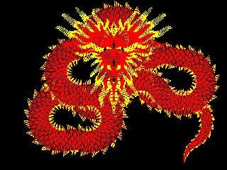

Red Chinese Procedural Dragon
MODE 2
Dim GCOL(3)=(RGB(YELLOW),RGB(RED),RGB(BLACK),RGB(WHITE))
S=Sin(.03):C=Cos(.03):X=260:Y=20:U=0:V=1
For A=80 To 1200
X=X+U:Y=Y+V:K=Sgn(Cos(A/45)*Cos(A*.0138))
T=U:U=U*C-K*V*S:V=V*C+K*T*S:Z=24-A Mod 10
For B=-Z To Z
R=1-80/A
CI=1+(Int(3*Abs(Cos(B*.3+(A\4 Mod 2)*Pi/2+.4)))=A Mod 4)-(Abs(B)>16)
Colour GCOL(CI)
Pixel 1*Int(X+R*B*V),250-1*(Y-R*B*U)
Next :Next
K=190
For J=0 To K
R=(200-80*Cos(J*3*Pi/K))*(.8+.5*Cos(J*13*Pi/K)*Cos(J*13*Pi/K))
For I=0 To R Step 5
CI=1.2-(I/R)-(J\20=4)*(2*(I\15=3)+1)-(J\12=14)*(I\30=3)
Colour GCOL(Abs(CI))
S=Sin(J*Pi/K):C=Cos(J*Pi/K):V=8*Sin(I/16)
Pixel 160+(I*S+V*C)/4,70-(I*C+V*S)/4
Pixel 160-(I*S+V*C)/4,70-(I*C+V*S)/4
Next : Next
Posts: 2807
Posted: 09:17pm 29 Sep 2024
impressive, code worked olimex pico2 hdmi modes 1 to 5. like

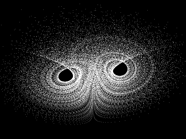

Posted: 12:35am 01 Oct 2024
Lorenz Attractor
Lorenz_System
MODE 1
x=3.051522: y=1.582542: z=15.62388
dt=0.04: a=5: b=15: c=1
 x1=x+a*(-x+y)*dt
 y1=y+(b*x-y-z*x)*dt
 z1=z+(-c*z+x*y)*dt
 x=x1: y=y1: z=z1
 px=Int(29*(y-x*.2)+320)
 py=Int(-15*(z+x*.2)+460)
 Pixel px,py

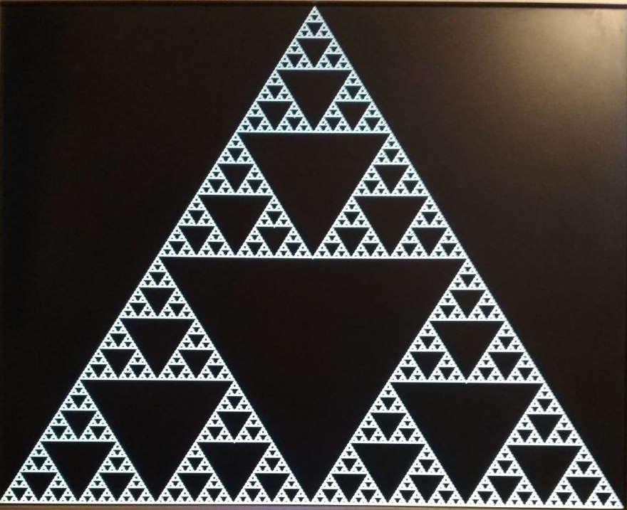

Posted: 03:51pm 01 Oct 2024
Sierpinski Triangle
WikipediA
MODE 1
RX=MM.HRes:RY=MM.VRes:CX=RX\2:CY=RX\2
 rs=Int(Rnd(1)*3)
 If rs=1 Then
   fx=CX:fy=0
 ElseIf rs=2 Then
   fx=0:fy=RY
 Else
   fx=RX:fy=RY
 EndIf
 x=(x+fx)\2
 y=(y+fy)\2
 Pixel x,y
Loop Until Inkey$<>""
Edited 2024-10-02 01:52 by javavi

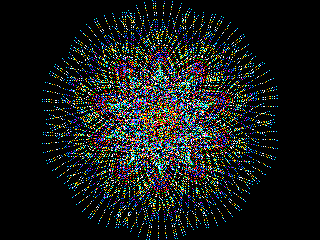

Posted: 05:08pm 03 Oct 2024
Star
MODE 2
RX=MM.HRes:RY=MM.VRes:CX=RX\2:CY=RY\2
RR1=150:RR2=-50:RR3=30:K=0.45:Q=0.1
For R1=RR1 To 187 Step 5
 For R2=RR2 To 240 Step 5
   Q=Rnd*2
   For R3=RR3 To 240 Step 5
     COL=Int(Rnd*&hFFFFFF)
     For T=0 To 600 Step Q
       X=Int((R1+R2)*Cos(R2*T/R1)-R3*Cos((R1+R2)/R1*T))
       Y=Int((R1+R2)*Sin(R2*T/R1)-R3*Sin((R1+R2)/R1*T))
       Pixel X*K+CX, Y*K+CY, COL
     Next T
   Next R3
   Pause 1000: CLS
 Next R2
Next R1
End

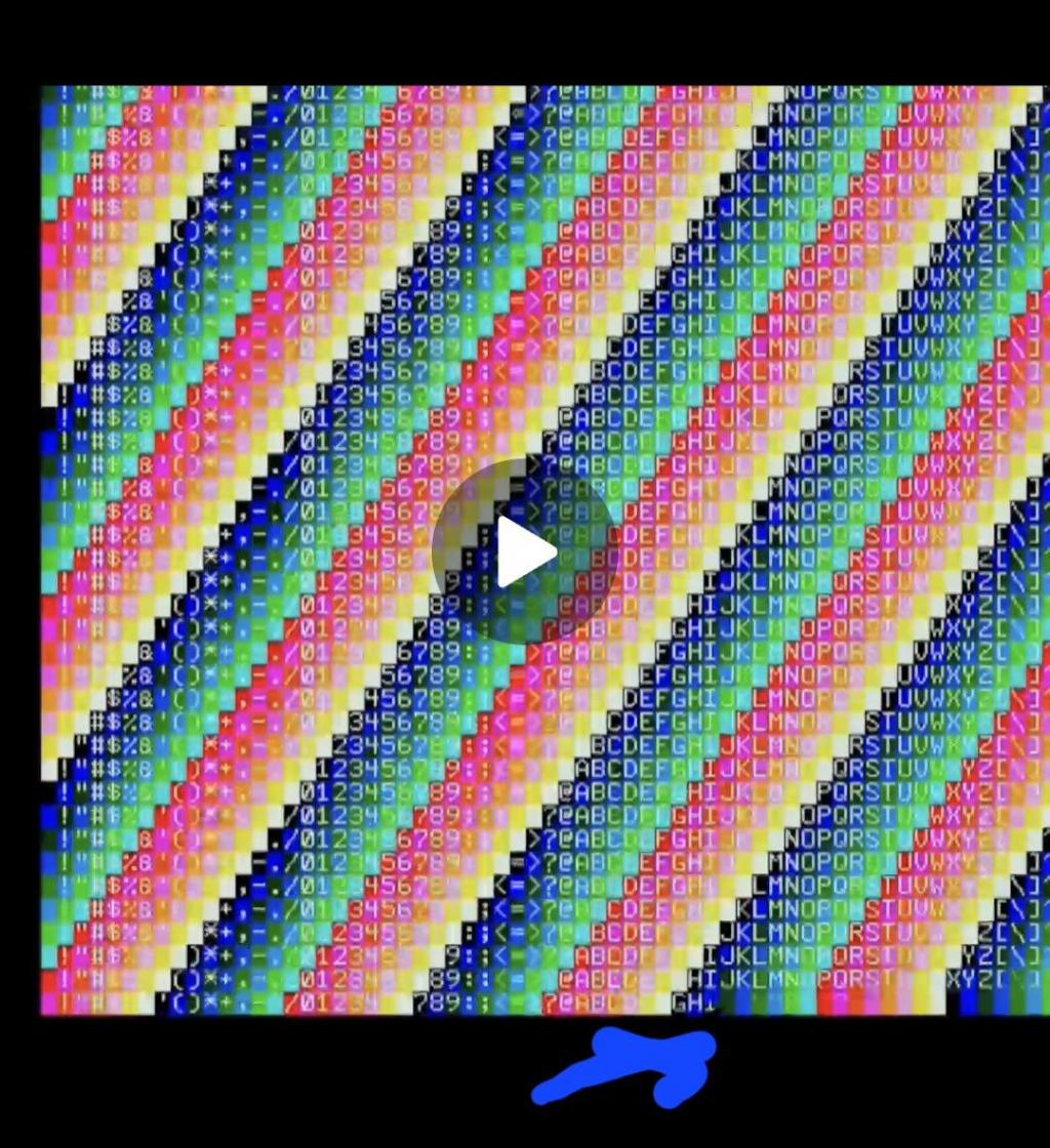

ch=32:bc=0
 For x=0 To 79
   Print Chr$(ch);
   TILE x,39,,Co(bc)
   Inc ch: If ch>111 Then ch=32
   Inc bc: bc=bc And 15
 Next x
Function CO(n)
CO=n And 1 Or ((n And 6)<<6) Or ((n And 8)<<13)
CO=CO<<7
End Function
