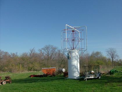

Hey everyone,
My daughter and grand daughter visited yesterday...first time they had seen the wings for the project. They were asking what I would name the thing?
Honestly, I had'nt given it a thought. But this was inspired "from the land down under" and so I was thinking maybe I should let you guys come up with a proper name.
I'd like to reserve the right to make the final decision, but you'r free to give it a go.
This picture was taken yesterday morning just after sunrise, notice the blue skys...I think they were sent in from California, not sure.
.....Mac46

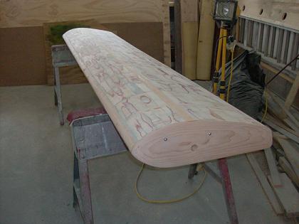

And here is the wing after final sanding and shapeing...ready for the next step, "Fiber glass".
.....Mac46

looks like a giant eggbeater. Name it after your wife, a safe bet. What rpm do you think this will turn at and what are you going to power with it? Maybe I have not read your posts correctly but am very curios. What is the tower size? Would never have dreamt of making it like that, partially because pipe that size is hard to find. Cheers

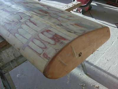

I used the woven fibberglass cloth, heavey guage, with the 12 min. epoxie. That means that you have 12 min.s to get it layed and satisfied after you mix in the hardener catilist."less in warmer conditions"
I solved this problem by glassing 1/3 of one side of the wing at a time and proceeding on to the next 1/3 and right on to the last 1/3rd. You can see I have a few folds that did'nt lay down, no problem, just take you'r sissors and cut the top of the fold and it should lay right down for you. You'll need to clean the sissors right away or else you won't be useing them again. This was my first experiance with fibberglass and it turned out pretty well. Hint, make sure you have disposeable gloves on, and don't rub you'r nose.
The stuff sets up rock hard and is sandable in a few hours. I was worried that it might warp the wing when it cured, but did'nt seem to shrink any.

The size is 24 feet from the floor surfice of the foundation to the top of the upper frame. The tube its self is approx. 5 feet 8 inches dia. x 13 feet 4 inches in height. It has 1/4 inch side wall thickness, and was salvaged from a steam boiler refit...was part of the old exaust stack.
I don't know what rpm it will run for a given wind speed, I could tell you what the mathmatics says it should run at, but at this point it would be just a guess. I'm hopeing for 200 rpm with 10 mph wind, but would be satisfied with half that. It may surprise everyone and do better or it may do worse too. But you'r right it should have lots of torque.
I'm think along the lines of 12 volt DC to charge storage batteries and also an air compressor to charge a 500 gallon tk. for the shop, but have'nt made final plans yet.
The wings themselves are approx. 9 feet 6 inches tip to tip and 2 feet wide,(cord).

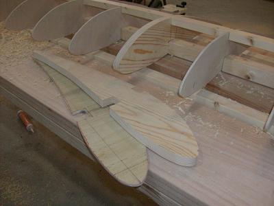

Continueing with the wing assembly aspect of the post...
Here is a real good picture of the GEO222 wing profile that I used. It is important to dry fit and check all the joints for binding and tightness, take the effort and make everything fit "just snug" and not tight, because later you'll be glueing lots of pieces together in a short time span. Believe me...you don't want to have to stop to make a proper fit on a few joints while the glue is drying on several other pieces next in line. Also, the glue will swell the wood slightly and make things fit even tighter than when dry fitted.
You can also see the differance in thickness in the ribs I've set out in front for you to see, the thin ones are for the main wing, while the thick ones are for the attachment areas. Notice the grain direction, some books say to lay it at a 45*-while others say 90* for strength, depends on what the rib is made of and how the material reacts during compression tests, but basicly speaking its stronger when the grain is vertical to the cord of the wing.

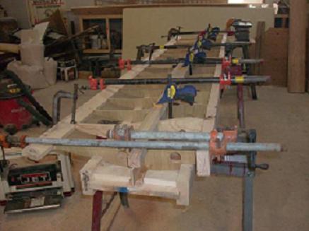

Alright...getting back to building the wing,
For one thing, you know you will nodought be building more than a single wing, and ofcourse you'll want these wings to be the same size and shape in all respects. So, You need a "jig"...
This way you can repeatidly make as many as needed, and be assured that they will be the same. Sometimes the jig is harder to make than the wing, certainly it must be as accurate as it can be with in reason. So take some time and plan this thing out, this is where you'r creativity comes in. Take you'r skills and talent and alittle imagination and put them to work. Its sorta like makeing a reverse mold for a casting. Keep it simple and durable. The jig in the picture took only took a short time to construct, but much longer to plan out ahead of time. So give it some thought.
Also you can see the vertical spar stiffeners...connects the upper and lower spars into a "I beam", extreamly strong, and variations of this are used in wings worldwide.
