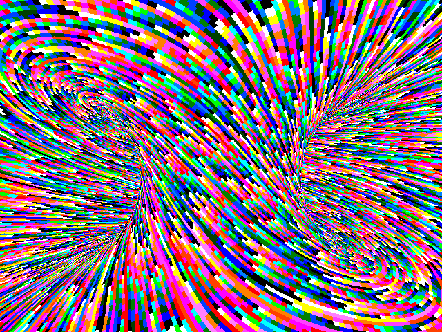

Stellarator RP2350 MODE 3  640x480 in colour
MODE 3
Map Reset
For U=0 To 319
 x1=U/256-1.255
 For V=0 To 479
   y1=V/256-1
   X=0:Y=X:Z=-2.4
     k=Sqr(X*X+Z*Z)-2
     d=1-Sqr(k*k+Y*Y)
     X=X+x1*d:Y=Y+y1*d:Z=Z+d
   Loop Until d<.01
   v1=Atn(Z/X)
   u1=Atn(Y/k)
   sColor(): Pixel U,V
   v1=3.13-v1
   sColor(): Pixel 639-U,V
 Next
Next
'Dim integer cm(15)=(0,1,2,3,4,5,6,7,8,9,10,11,12,13,14,15)
'Dim integer cm(15)=(0,15,7,1,0,0,0,0,0,0,0,0,0,0,0,0)
Dim integer cm(15)=(0,15,14,6,4,2,0,0,0,0,0,0,0,0,0,0)
Colour Map cm(),cm()
 T=cm(0)
 For i=0 To 14:cm(i)=cm(i+1):Next
 cm(15)=T
 For i=0 To 15:Map(i)=cm(i):Next
 Map Set
 Pause 50
Sub sColor()
 p=Sin(Int((u1+v1)*40)*99)*98
 c=15 And ((u1-v1+p)*24*Abs(Sin(p)))
 Color Map(c)
End Sub

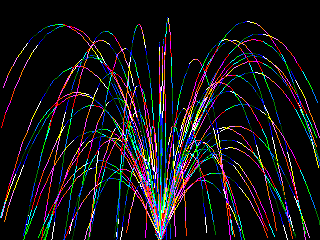

Fire Show Fountain
MODE 2
Map Reset
For I=0 To 2100
If Y>230 Then
 X=160
 Y=240
 x0=X:y0=Y
 x1=Cos(Rnd*Pi)*5
 y1=5+Rnd*16
EndIf
 X=X+x1:Y=Y-y1:y1=y1-1
 Inc C,-1:If C<1 Then C=15
 Color Map(C)
 If X>0 And X<320 Then Line x0,y0,X,Y
 x0=X:y0=Y
Next
For N=0 To 14
  T=cm(1)
  For i=1 To 14:cm(i)=cm(i+1):Next
  cm(15)=T
  For i=1 To 15:Map(i)=cm(i):Next
  Map Set
  Pause 100
Next
For i=1 To 15
  If i<3 Then cm(i)=Map(Int(Rnd*15)) Else cm(i)=0
Next

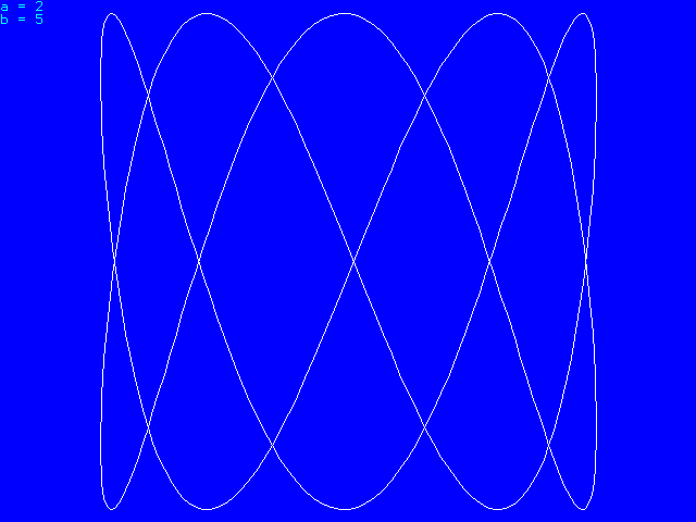

∞ Lissajous Figures ∞
Option ANGLE DEGREES
FRAMEBUFFER CREATE
FRAMEBUFFER WRITE F
Colour RGB(Cyan),RGB(Blue)
CX=MM.HRes/2: CY=MM.VRes/2
Scale=0.95: AX=CY*Scale: AY=CY*Scale
a=1: b=0: p=0: f=0: c=0
 If p>360 Then p=0: EndIf
 If b>6   Then a=a+1: b=0: c=0: EndIf
 If a>5   Then a=1:   b=0: c=0: EndIf
 If c=50  Then
   f=1
   If a=Fix(b) Then f=0: c=0: EndIf
 EndIf
 If c=130 Then f=0: c=0: EndIf
 CLS
     sx= AX * Sin(p) + CX
     sy= AY * Sin(p) + CY
 For i= 0 To 360
     x = AX * Sin(a*i + p) + CX
     y = AY * Sin(b*i + p) + CY
     Line sx,sy,x,y
     sx=x: sy=y
 Next i
 Print "a ="a: Print "b ="b
 FRAMEBUFFER COPY F,N,B
 Inc p: Inc c
 If  f=0 Then b=b+.02: EndIf
Loop Until Inkey$ <> ""
End

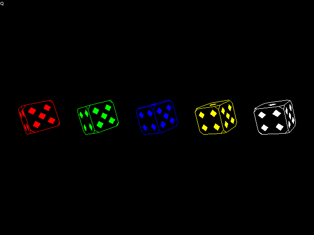

3D Dice
MODE 1
TILE 0,0,RGB(RED),RGB(BLACK),16,40
TILE 16,0,RGB(GREEN),RGB(BLACK),16,40
TILE 32,0,RGB(BLUE),RGB(BLACK),16,40
TILE 48,0,RGB(YELLOW),RGB(BLACK),16,40
'Print "3D Draw"
Dim n=1, nv=24, nf=6+8, camera=1
' Load vertices arrey
Dim v(2,nv-1)
Restore vertices2
For i=0 To nv-1: For a=0 To 2: Read v(a,i):Next :Next
' Load facecount arrey
Dim INTEGER facecount(nf-1), facesize=0
Restore facecount2
For i=0 To nf-1: Read facecount(i): Inc facesize,facecount(i): Next
' Load faces arrey
Dim INTEGER faces(facesize-1)
Restore faces2
For i=0 To facesize-1: Read faces(i): Next
' Load colours arreys
Dim INTEGER c(1)=(0,RGB(GREEN))
Dim INTEGER edge(nf-1)=(1,1,1,1,1,1, 1,1,1,1,1,1,1,1)
Dim INTEGER fill(nf-1)=(0,0,0,0,0,0, 0,0,0,0,0,0,0,0)
Math SCALE v(), 100.0, v()
Draw3D CREATE 1,nv,nf,camera,v(),facecount(),faces(),c(),edge(),fill()
Draw3D CREATE 2,nv,nf,camera,v(),facecount(),faces(),c(),edge(),fill()
Draw3D CREATE 3,nv,nf,camera,v(),facecount(),faces(),c(),edge(),fill()
Draw3D CREATE 4,nv,nf,camera,v(),facecount(),faces(),c(),edge(),fill()
Draw3D CREATE 5,nv,nf,camera,v(),facecount(),faces(),c(),edge(),fill()
nv=84: nf=21: camera=1
Dim v1(2,nv-1)
Restore vertices3
For i=0 To nv-1: For a=0 To 2: Read v1(a,i):Next :Next
Dim INTEGER facecount1(nf-1)
facesize=0
Restore facecount3
For i=0 To nf-1: Read facecount1(i): Inc facesize,facecount1(i): Next
' Load faces arrey
Dim INTEGER faces1(facesize-1)
Restore faces3
For i=0 To facesize-1: Read faces1(i): Next
Dim INTEGER edge1(nf-1)=(1,1,1,1,1,1,1,1,1,1,1,1,1,1,1,1,1,1,1,1,1)
Dim INTEGER fill1(nf-1)=(1,1,1,1,1,1,1,1,1,1,1,1,1,1,1,1,1,1,1,1,1)
Math SCALE v1(), 100.0, v1()
Draw3D CREATE 6,nv,nf,camera,v1(),facecount1(),faces1(),c(),edge1(),fill1()
Dim INTEGER viewplane=400
Draw3D CAMERA n, viewplane
Dim INTEGER x=0, y=0, z=6000
'Draw3D SHOW n, x, y, z
'END
Dim FLOAT yaw=Rad(1), pitch=Rad(2), roll=Rad(0.5)
Dim FLOAT q(4)
FRAMEBUFFER CREATE
FRAMEBUFFER WRITE F
 Math Q_EULER yaw, pitch, roll, q()
 Draw3D ROTATE q(),1
 Draw3D ROTATE q(),2
 Draw3D ROTATE q(),3
 Draw3D ROTATE q(),4
 Draw3D ROTATE q(),5
 Draw3D ROTATE q(),6
 Draw3D SHOW  1,x,y,z
 Draw3D WRITE 6,x,y,z
 Draw3D SHOW  2,-1800,y,z
 Draw3D WRITE 6,-1800,y,z
 Draw3D SHOW  3,-3600,y,z
 Draw3D WRITE 6,-3600,y,z
 Draw3D SHOW  4,1800,y,z
 Draw3D WRITE 6,1800,y,z
 Draw3D SHOW  5,3600,y,z
 Draw3D WRITE 6,3600,y,z
 Inc yaw,Rad(4)    '1
 Inc pitch,Rad(8)  '2
 Inc roll,Rad(2)   '0.5
 FRAMEBUFFER copy F,N,b
Loop Until Inkey$<>""
FRAMEBUFFER WRITE N
Memory
FRAMEBUFFER close
End

Martin H.
Joined: 04/06/2022
Posts: 1583
Posted: 10:58am 13 Dec 2024
Nice Dice
'no comment
Posts: 12252
Posted: 11:31am 13 Dec 2024
Great to see the 3d code in use again

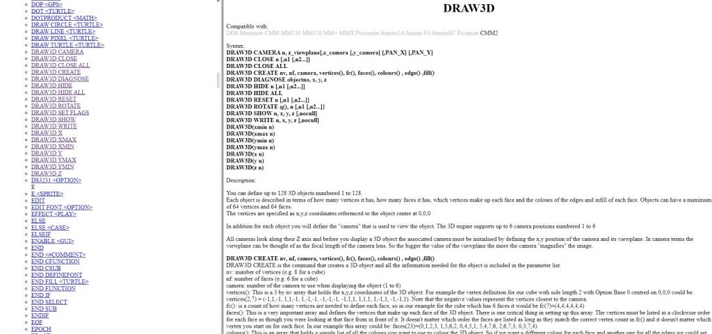

which manual is Draw3d explained please?
I found Math Q_EULER yaw, pitch, roll, q().
now found See the document “The CMM2 3D engine” in the PicoMiteVGA firmware
download for a full description.
Edited 2024-12-14 05:02 by stanleyella
Posts: 9383
Posted: 07:03pm 13 Dec 2024
CMM2 has it, Stan. I'm not sure if it's been in a Pico manual yet.
Posts: 2807
Posted: 07:45pm 13 Dec 2024
thanks for replying Mick but clueless where, just relevant draw3d info and the 3d dice pico 2 works
Turbo46
Joined: 24/12/2017
Posts: 1694
Posted: 07:49pm 13 Dec 2024
@Stan,
From the PicoMite manual:
3D Engine
NOT AVAILABLE IN WEBMITE VERSIONS
The 3D Engine includes ten commands for manipulating 3D images including setting the camera, creating, hiding, rotating, etc. See the document The CMM2 3D engine.pdf in the PicoMite firmware download for a full description of these commands and how to use them.
Bill
Posts: 2807
Posted: 08:59pm 13 Dec 2024
I got a shortcut to the online manual
https://www.c-com.com.au/mmhelp/
Edited 2024-12-14 07:32 by stanleyella
