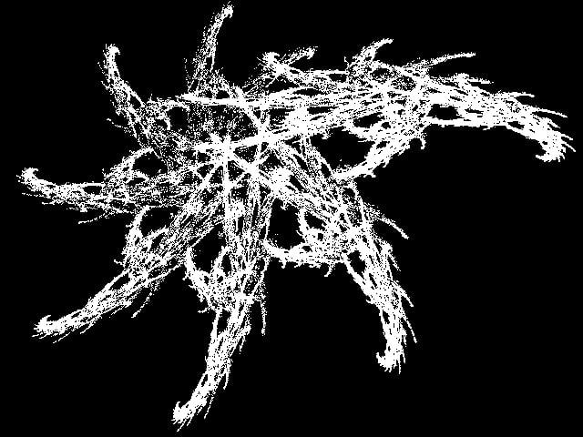

Evil Fractal
CLS
 If Cint(Rnd) Then
   T=(X+Y)/2
   Y=(Y-X)/1.333
   X=T
 Else
   T=(X+Y+1)/2
   Y=(Y-X+1)/4
   X=T
 EndIf
 Pixel 240+X*350,170-Y*290
Loop While Inkey$=""

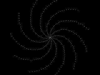

Whirlwind
X0=MM.HRES\2: Y0=MM.VRES\2
 X=MM.HRES/800:Y=0
 Inc I,.1: If i=360 Then i=1
 C=Cos(i): S=Sin(i)
 CLS
 For R=1 To 320
   Pixel X0+R*X,Y0+R*Y
   T=X*C-Y*S
   Y=X*S+Y*C
   X=T
 Next
 Pause 50

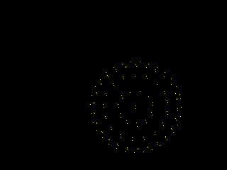

javavi
Joined: 01/10/2023
Location: Ukraine
Posts: 642
Posted: 02:34pm 11 Jun 2025

RotaSphere
MODE 2
Dim Xa(255), Ya(255)
x0=MM.HRES\2:y0=MM.VRES\2
Xdir=1:Ydir=1:C=Map(14)
n=4
r=n*16
 i=0
 t=Timer
 tr=t-n*50
 ra=tr/1234
 rb=tr/2345
 For a=0 To Pi Step .39268
   For b=0 To Pi*2 Step .8-.6*Sin(a)
     o=Sin(a)*Cos(b)
     k=Sin(a)*Sin(b)
     e=Cos(a)*Cos(ra)+k*Sin(ra)
     Pixel Xa(i),Ya(i),0
     Xa(i)=(o*Cos(rb)+e*Sin(rb))*r+x0
     Ya(i)=(e*Cos(rb)-o*Sin(rb))*r+y0
     Pixel Xa(i),Ya(i),C
     Inc i
   Next b
 Next a
 If x0<r Then Xdir=1:C=Map(Int(Rnd*16))
 If y0<r Then Ydir=1:C=Map(Int(Rnd*16))
 If x0>MM.HRES-r Then Xdir=-1:C=Map(Int(Rnd*16))
 If y0>MM.VRES-r Then Ydir=-1:C=Map(Int(Rnd*16))
 Inc x0,Xdir:Inc y0,Ydir

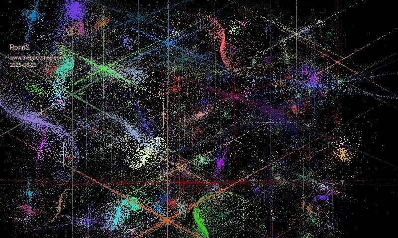

  javavi said
  lizby said  Beautiful. Amazing what 30 lines of code can do. Thanks for working these out, and hope more is to come.
To run with ILI9341 LCD, I commented out the TILEs line, changed the sizing
On such screens, "The Mystery of Deep Space" can be viewed in color ;))
MODE 2
CLS
For G=-Rnd*42 To 400
tt=Rnd*99:  qq=Rnd*99
uu=Rnd*320: vv=Rnd*240
A=Rnd*3
R=90/(1+Rnd*100)
Q=1+3*(.5+Rnd/2)
aa=1+3*Rnd^2: M=1
If Rnd*9<4 Then Q=R:T=0:qq=0:A=0:M=Pi/3:aa=1
C=(1+3*Rnd^2)*R*R
Color Rnd*&hFFFFFF
For i=0 To C
  S=-Log(Rnd):  T=i*M
  U=S*R*Sin(T): V=S*Q*Cos(T)
  T=S*A
  X=U*Cos(T)+V*Sin(T)
  Y=V*Cos(T)-U*Sin(T)
  D=(X*X+Y*Y)/(R*R+Q*Q)
  Z=99*((2.7^-D)+.1)
  Z=Z*(Rnd-.5)^3
  y0=Y*Cos(tt)+Z*Sin(tt)
  Z=Z*Cos(tt)-Y*Sin(tt)
  x0=uu+X*Cos(qq)+y0*Sin(qq)
  y0=vv-X*Sin(qq)+y0*Cos(qq)
  Pixel x0,y0
Next
Next
Hello Javavi, I find your code so beautiful and have translated it into another basic language - do I have your permission to also publish the result on another site (with acknowledgment of the author)?
see pic
run  at  a  800x600 display
