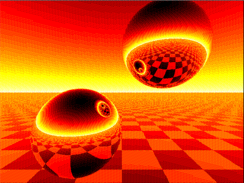

Hi javavi,
Wauw. This is beautifull. I did not have VGA system at hand, so I converted it to Game*Mite (any color LCD would do). But this is amazing. It feels like we could convert the whole of the universe into a few lines of MMBasic. Thank you. Between your demo's there are some real gems, pure diamond, and this is one of them.
dim cmap(15)'MODE 2
cMap(1)=RGB(Red)
cMap(2)=RGB(Yellow)
cMap(3)=RGB(White)
'Map set
For N=0 To 239
For M=0 To 319
X=0:Y=-.1:Z=3
U=(M-159.5)/160:V=(N-117.5)/160
W=1/Sqr(U*U+V*V+1):U=U*W:V=V*W
I=Sgn(U):G=1
E=X-I:F=Y-I:P=U*E+V*F-W*Z
D=P*P-E*E-F*F-Z*Z+1
If D>0 Then
 T=-P-Sqr(D)
 If T>0 Then
  X=X+T*U:Y=Y+T*V:Z=Z-T*W:E=X-I:F=Y-I:G=Z
  P=2*(U*E+V*F-W*G):U=U-P*E:V=V-P*F:W=W+P*G:I=-I
 EndIf
EndIf
If V<0 Then
 P=(Y+2)/V:V=-V*((Int(X-U*P)+Int(Z-W*P)And 1)/2+.3)+.2
EndIf
Color cMap(3-(48*Sqr(V)+(7*(M+4*N))Mod 16)\16)
Pixel M,240-N
Next
Next

Fascinating. I have no idea how the programme works, but Harms version also runs smoothly in mode 7 under mmbasic for Windows.
Here in 640x480 Picomite HDMI Mode 3 or CMM2/MMBASIC4Windows Mode 1

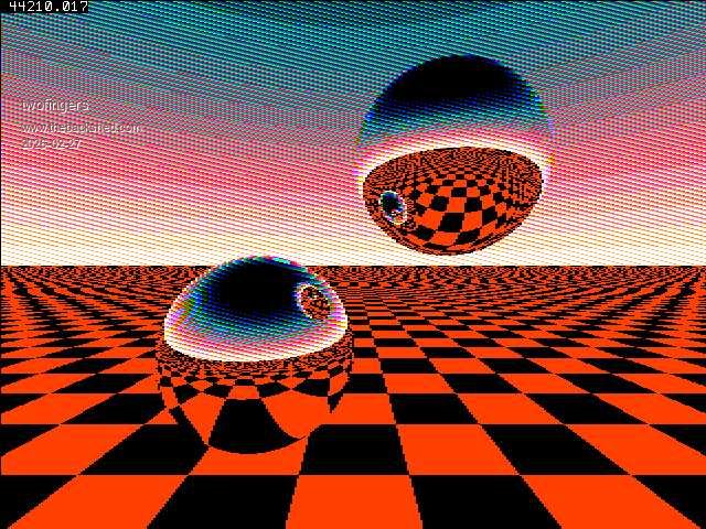

Hi Martin(/Harm/Vadim),
I hope you don't mind that I modified your code. I was playing around with it a bit (along with AI, since I don't really understand the code ;-)).
My goal was to explore the possibilities for speed optimization in pure BASIC.
For a faster speed (now 44 seconds on 640x480 display), I halved the resolution (using double pixels)!
MODE 3:CLS :Map RESET:Timer =0
Dim Float x,y,z,u,v,w,e,f,p,d,t,uo,vo,tp,v2,xi,zi,i3=1/320
Dim Integer m,n,k,o,c,uc=320,vc=240
Dim Integer G(15)=(0,1,2,3,4,5,6,7,8,9,10,11,12,13,14,15)
Colour Map G(),G()
For n=0 To 479:vo=(n-vc)*i3:v2=vo*vo+1:o=28*n
For m=1 To 640 Step 2
x=0:y=-.1:z=3.8:uo=(m-uc)*i3:w=1/Sqr(uo*uo+v2):u=uo*w:v=vo*w:i=Sgn(u)
 e=x-i:f=y-i:p=u*e+v*f-w*z:d=p*p-e*e-f*f-z*z+1:If d<=0 Then Exit Do
 t=-p-Sqr(d):If t<0 Then Exit Do
 Inc x,t*u:Inc y,t*v:Inc z,-t*w:e=x-i
 p=2*(u*e+v*(y-i)-w*z):Inc u,-p*e:Inc v,-p*(y-i):Inc w,p*z:i=-i
If v<0 Then
 tp=(y+2)/v:xi=x-u*tp:zi=z-w*tp
 k=((xi+4096)+Int(zi+4096))And 1
 c=10-k*10
Else
 c=Int(14-v*25+((7*m+o)Mod 16)\2)
EndIf
c=c*(c>0 And c<15)+15*(c>=15)
Line m,480-n,m+1,480-n,,G(c):Next
Next
Print Timer

Michael

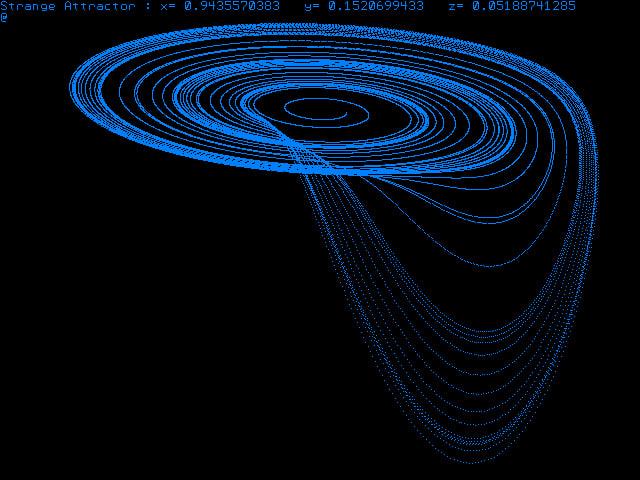

Rössler's Strange Attractor
A strange attractor is an attractive set in the phase space of a dissipative dynamical system, characterized by a complex fractal structure and chaotic trajectory behavior. Unlike conventional attractors (points or cycles), a strange attractor is not a simple curve or surface, and trajectories within it are unstable and exhibit high sensitivity to initial conditions.
MODE 1
Dim a=0.2, b=0.2, c=5.7
Dim x=0.1, y=0, z=0
Dim dt=0.005
Dim dx, dy, dz
Dim INTEGER i, x0=320, y0=110
Dim INTEGER CM(15)=(0,1,2,3,4,5,6,7,8,9,10,11,12,13,14,15)
Colour Map  CM(),CM()
Color CM(Int(Rnd*15)+1): CLS 0
x=Rnd
For i = 1 To 50000
 dx = (-y - z) * dt
 dy = (x + a * y) * dt
 dz = (b + z * (x - c)) * dt
 x = x + dx
 y = y + dy
 z = z + dz
 Pixel x0+x*26+y*8, y0+z*14+y*8
 If Inkey$ <> "" Then Exit Do
Next i
Pause 4000
